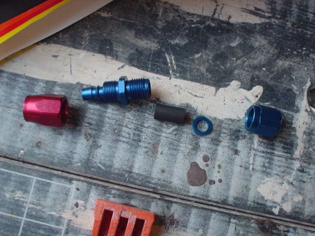

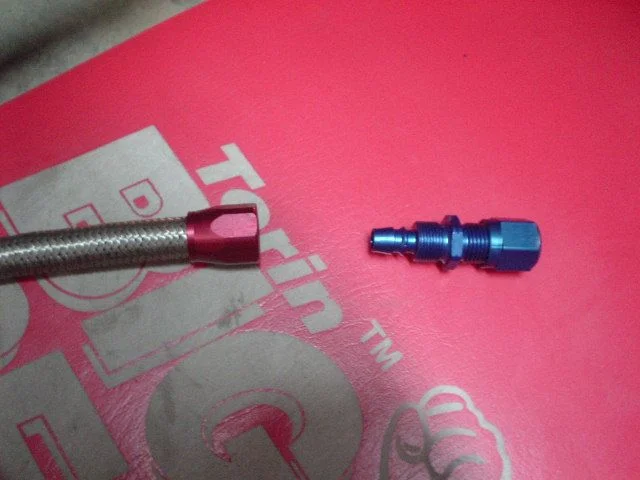

Then I started to assemble the other side once I cut the line to length. I actually cut it with a cut off wheel as the SS was so tough. Here is a pick of the fitting itself.
Name:  Fuel Line 009.jpg
And assembly pretty much the same as before but this fitting is made by Earls so it is a bit different.
Name:  Fuel Line 011.jpg

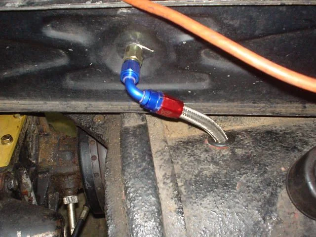

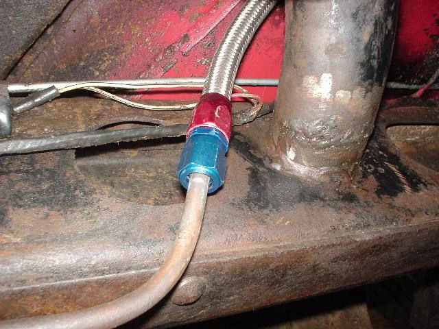

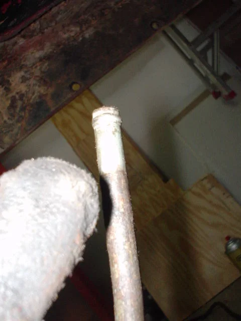

So I then got under the truck and cut the flared end off the hardline...
Name:  Fuel Line 010.jpg
...and connected the very cool compression fitting.
Name:  Fuel Line 012.jpg

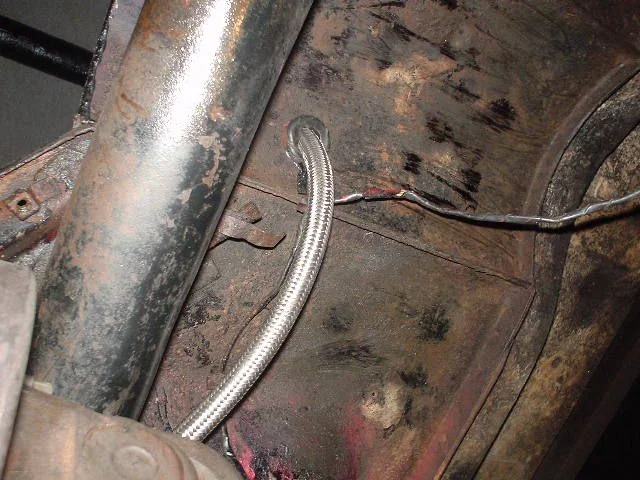

Here is a pic of the line going into the bottom of the truck.
Name:  Fuel Line 013.jpg
So pretty easy once I got all the parts and I think it is pretty sanitary too. So, Roger, laugh all you want, you know you want some bitchin' -AN fittings to flow some diesel through!!!!!

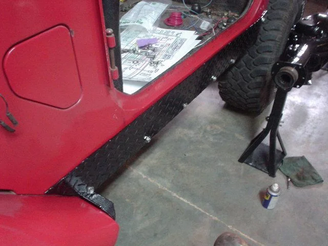

Here is an update. I put on my pseudo-sliders that I had Sean powdercoat. I usually do not like this stuff and it affords no real protection but the holes are there and they look clean with the coating:

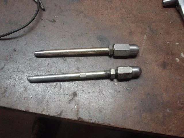

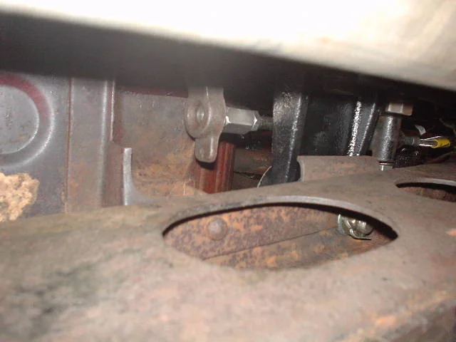

I also got my new clutch rod from my friend with the Harley Davidson shop (Street Chrome on Hwy 27) here in town. Who said free was not a good price? It is 2mm bigger then the stock one to prevent it from pushing through the worn out clutch arm:
Here it is in action. I blead the system (SOOOO much easier then bleeding brakes) and got the truck to move back and forth under its own power! Very cool. I doo need to adjust the pedal free play.

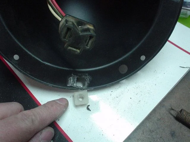

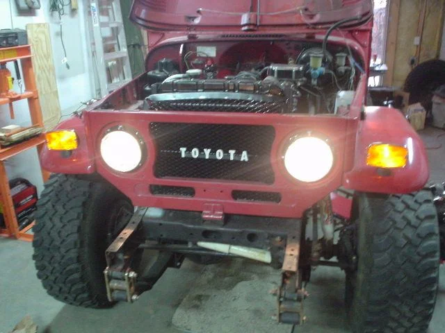

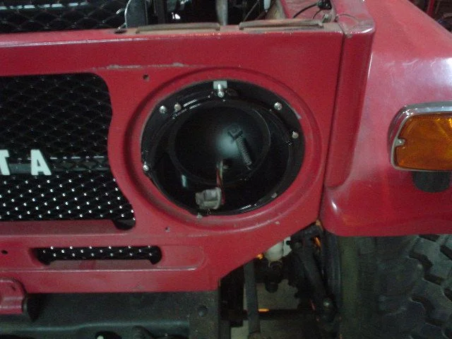

Head Light Tech!
Well, I had a head light burn out while I was cleaning up the electrical stuff and when I when to replace it, realized averything in the buckets was a rusty mess. So I took it all apart and blasted everything but the tubs becasue if I had forced the wires out of them I would have to buy new grommets.
I got Sena to powder coat the adjustable mounts and the mounting rings that go in the engine compartment and went out and found myself some square GM type plastic adjuster screw nuts and new adjuster screws for $4 at Auto Zone. I had to use my dremel to square the holes in the tub but it worked great!
Here it is put back together with new stainles harware.
And finally - Tah Dah!
Since the truck is not yet really road worthy, I did not bother to put the bezel back on cuz I will need to adjust those headlights some and can't do it agains my work bench!

the 40 year old flasher.
no thanks
nice square cut out on the housing! did you touch it up with paint or leave it for the rust fairy?

Quote:
Originally Posted by sk8salomon View Post
no thanks
Taken care of with Zero Rust.

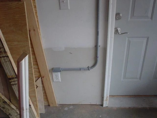

I took Sunday off from working on the 40 to run a new outlet to get my radio in the garage off the hydraulic press and someplace it could get some stations. Is this code???
