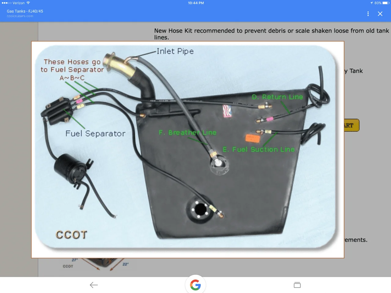

What about the PS pump on the 62?I bled the clutch and got it working, but the brake master is bad.pulled the gas tank and looking to see how all the hoses hook up. there are 5 ports plus the fill and overflow. Fortunatly the fuel supply is marked.

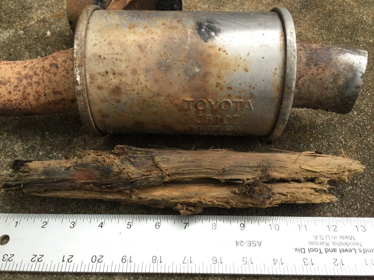

i got the inside cleaned out and found some small parts I need.
