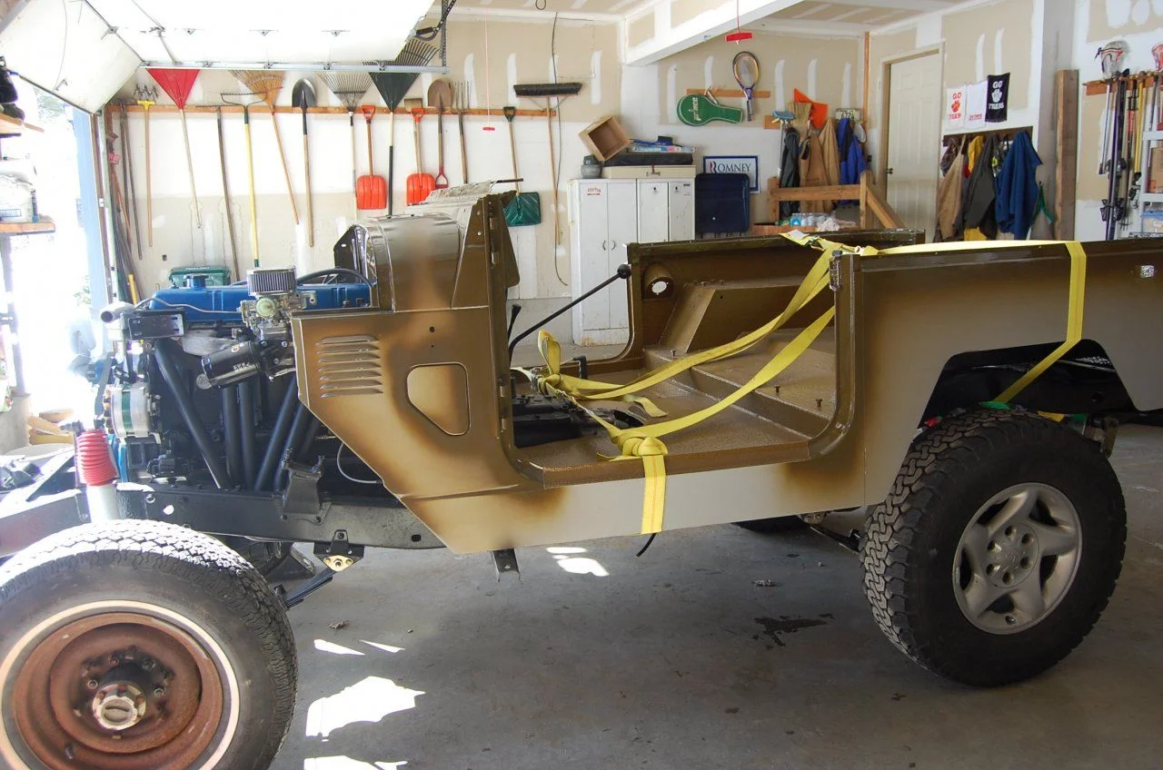

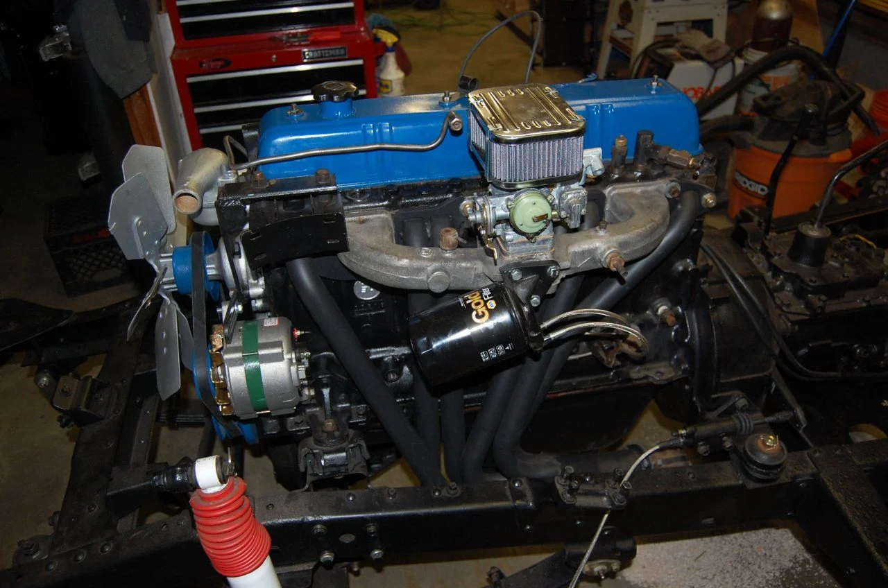

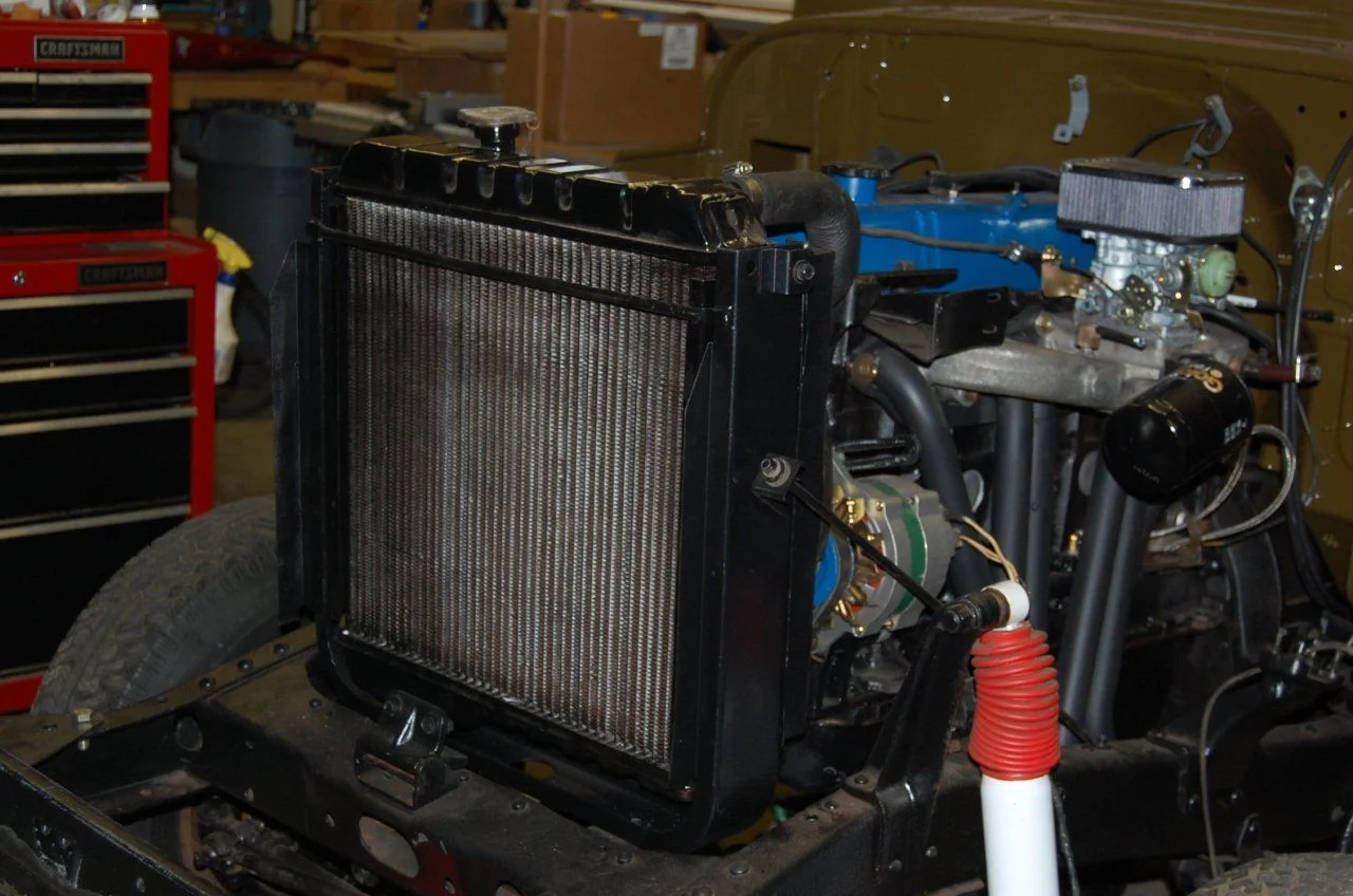

I hear you 1973barnfind. I am having a tough time getting my rig running after a rebuild. I am pretty mechanically inclined but not a mechanic. Trying to find someone locally to help me out has been tough. Hang in there. It will be all the more worth it when you are done. Currently piecing my rig back together and hoping to get it running for summer. Time will tell.
