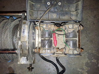

Opening the control box, I found dirty solonoids that need cleaning, but the wires are in good shape.
Dirty Solonoids

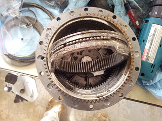

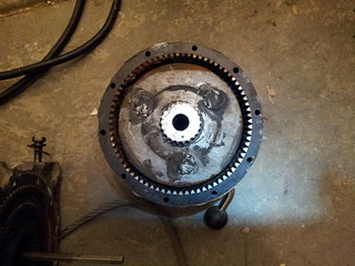

Opening up the housing for the planetary gears, things look okay, but need to dig in further to get an idea of condition
top of planetary gears

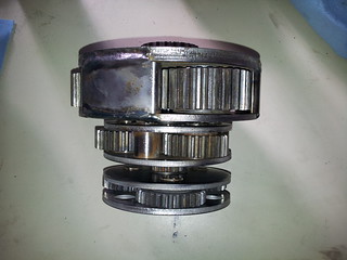

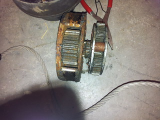

Break down of planetary gears. A lot of caked on dirty grease. A little rust is present but not on the actual gears
planetary gears

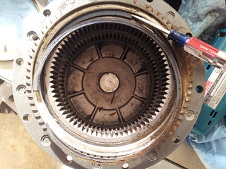

Teeth in the housing look good
Housing

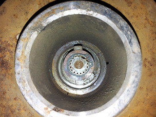

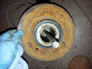

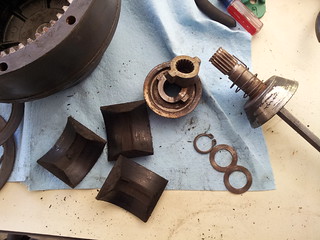

I wanted to completely clean up the winch, and doing so meant doing a deep clean of the drum. To do this effectively (and easily) I went ahead and removed the brake (even though Warn tells you not to do this unless replacing). With the winch being 20 years old, I thought it wise to completely dismantle. If I can't rebuild the brake components I will have to buy a new pre-assembled piece.
rust on drum
C-clip holding brake in drum
brake components

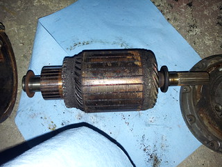

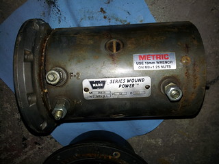

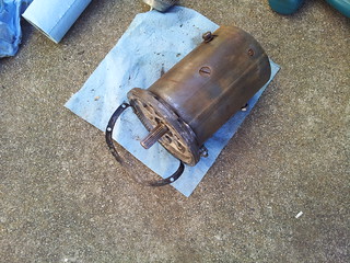

I will be the first to admit I do not know much about electric motors. Here are some pics from the housing and motor itself. Brushes look almost new. However it looks like maybe the motor got hot. Hard to say, as much of the discoloration is actually varnish that was sprayed on during the manufacturing process. I know this because I accidentally took a bit of the varnish off when cleaning the copper. I need to fix that. :doh:
motor housing with old gasket
motor housing
motor and housing
motor close up
inside of motor housing

Planetary Gears
Planetary Gears

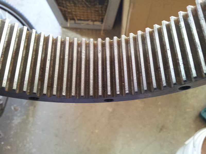

I did notice some pitting due to the rust build up and age of the winch. However, I am sure it will be just fine. I sanded the pitted areas to smooth it out a bit.
pitting from rusting steel ball bearings
pitting on gear teeth

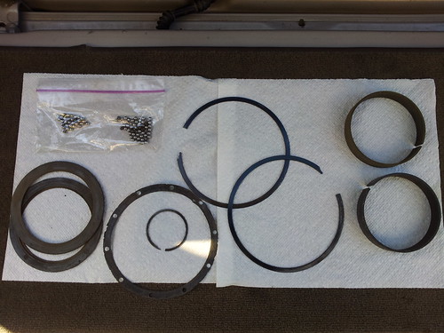

Getting ready to order replacement parts for my Winch. Besides the stickers, what are the recommended replacement parts for a standard rebuild?
There are some plastic bushings, snap rings, steel ball bearings and a few gaskets in my M12000.
  • All gaskets in the winch are a no brainer...they need replacing.
  • I'd like to reuse the snap rings...I was gentle taking these off. These aren't bent, so I should be able to reuse, correct?
  • This would seem like a good time to replace the plastic bushings. But is that necessary?
  • Some of the ball bearings are rusted. I figure I will replace all of these. Bearings from Warn are pricey, so I'll probably order from eBay. Does anyone know what specific type of ball bearings these are i.e. what hardness, stainless steel vs. chrome, etc.?

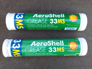

Got my winch grease in the mail this past week. Warn recommends a moly fortified NLGI #1 grease. The #1 moly grease is spec'd for stability at high heat and heavy shock loads, and is used in low viscosity applications, such as enclosed gear drives operating at low speeds. The #1 also has better low temp pumpability.
I couldn't find any NLGI#1 Moly Grease at my local parts stores (only NLGI#2), so I went ahead and ordered the specific brand that Warn recommends...AeroShell 33MS (replaces AeroShell 17). Kinda pricey, but not much more than the synthetic NLGI#2 grease when ordered online.
AeroShell 33MS
A Warn tech told me to only use enough grease to fill in the teeth of the gears. But then again mine wasn't the one with all the bearings.

I probably used twice the recommended amount of grease that Warn recommended. They say to use just enough to fill the gear teeth. That seemed to invite more corrosion (than it already had) so I covered everything with a light coating. Its been 1.5 years so maybe I'll open it back up and inspect. But it works just fine with no signs of trouble.
