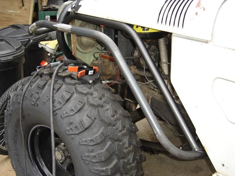

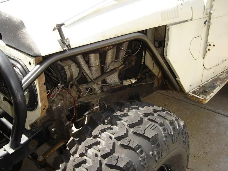

    i needed to do something with my front fenders ever since extending my wheel base to 104"
    sooo, i started tackling this awhile back and finally got a chance to start mounting them up.
    i started by mocking up the left fender first. took all my notes and bending angles and measurements, then made the right fender with just the specs (no mock up)
    i will still add bracing and plan on making a x-piece that will be removable from fender to fender and connect them to the bib.
    i might even mount my shocks to them.
    pics are in order of build.
    :D

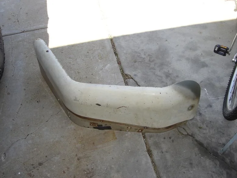

    the last pic here is of the perfect 69 fender that i cut up and not even sure if i'll use it to skin these :D

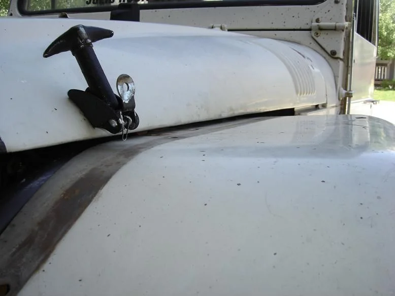

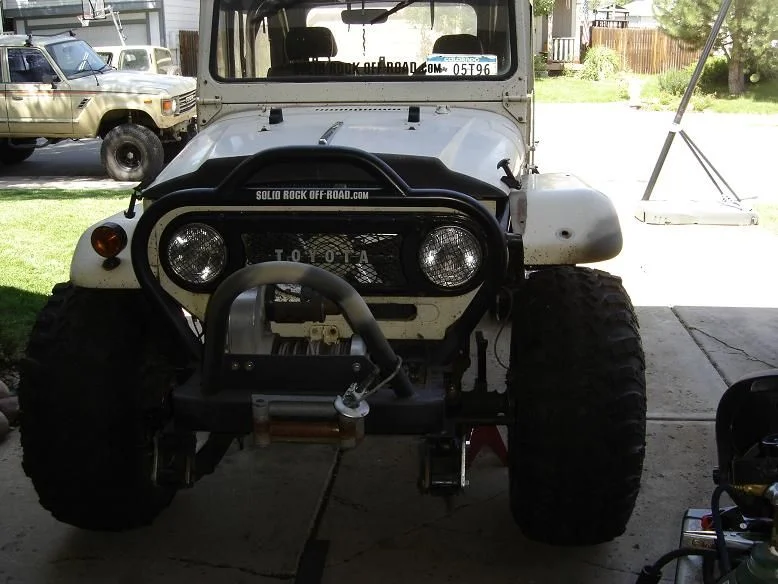

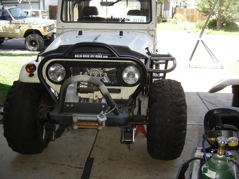

    before and after pic between fenders
    body line at the hood

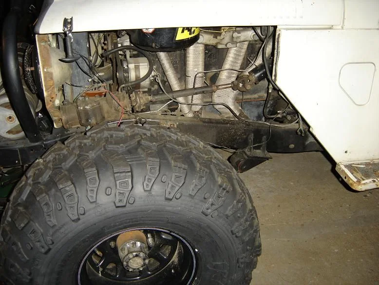

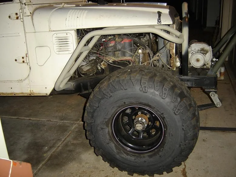

    last ones for now of the right side.
    put a bit o' paint on them to slow the rusting out in the weather.
    BTW, these are tied into the hood hoop, not the bib.

    I see where you had to butt weld twice ;p That compound curve in the front takes some tricky measuring & tube adjustment on the bender. I'd have to do the same thing. Looks :smokin: You using 1 1/2" HREW?
  8. 2badfjs
    2badfjs
    Messages:
    5,522
    Likes Received:
    2
    Joined:
    Jan 26, 2005
    Location:
    in the garage
    thanks LC, thanks guys!
    i figured if i overshot a measurement i could butt weld it. i measured the cut and readjusted where the bend started on the right fender.(no butt weld there);)
    but the compound bend at the front had to be cut and rewelded to get the two bends to look right.
    the stock fender fits pretty good.
    yup, 1.5 hrew
