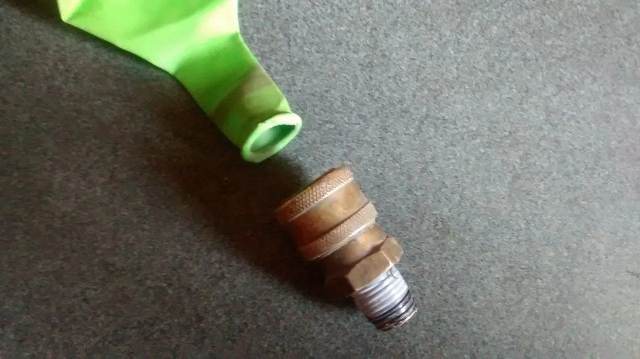

I've recently put back together my 1989 3fe after getting it back from the machine shop. Now I'm attempting to find TDC to then set the dizzy. I made a little port stem and balloon to stick in to plug port for cylinder #1. I hand crank the crankshaft bolt, and It works perfectly, very obvious when compression begins and or tapers off.

So I like the zip tie technique. Gonna try that. My balloon works but I can see where the zip tie could be more accurate.

So basically I took an old brass airchuck fitting and a balloon, put some Teflon tape over the male threads of the airchuck threaded the Chuck into cylinder #1 and turned the crankshaft.
The threading diameter on the airchuck is slightly less than that of the spark plug, so the use of the Teflon tape not only helps with this size discrepancy but also provides an ok air seal.

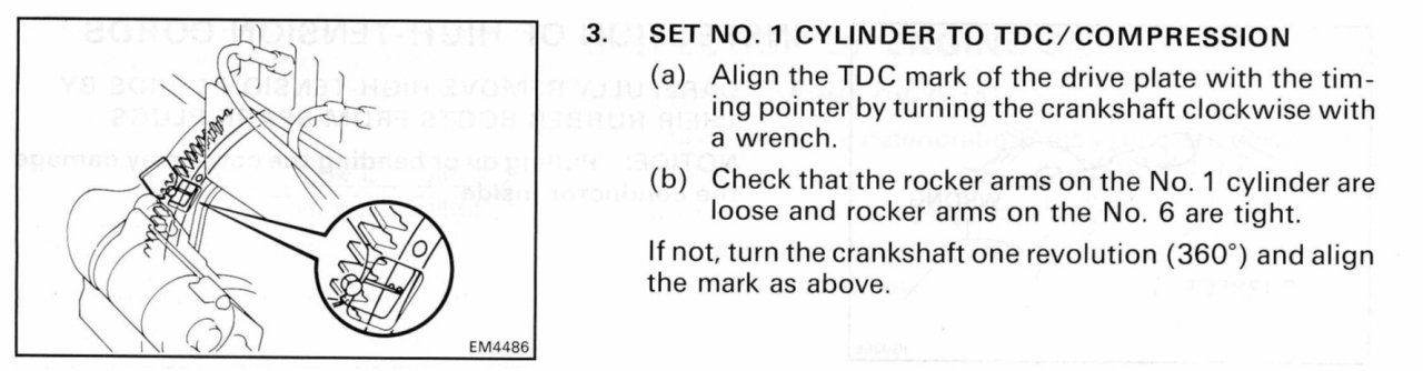

Your motor doesn't have a timing mark? Turn the motor in the normal direction, stick your finger in the #1 plug hole, when you feel pressure, start watching for the timing mark. Set it on the mark, adjust the dizzy, put the plug, etc, back on, start the motor and set the timing with the light.
Take off the oil cap and feel the rockers on #1 with your finger. If the piston is at the top of the stroke as verified by a zip tie in the spark plug hole, and the timing mark on the drive plate lines up with the pointer...AND both rockers are loose for #1, you're at TDC compression.

I am not clear if the two rocker arms for cylinder#1 are side by side, or is it one rocker arm for cylinder#1 then skip one then the third rocker arm is the second rocker for cylinder #1 ?

It seems that at no point does the second rockerarm for cylinder #1(2nd back from front or the I valve ) ever get loose. At one point it loosens enough to sorta lightly force to one side but it wants to stick there. I wouldn't guess that it is supposed to do that. However obviously I'm no expert on this issue :)
