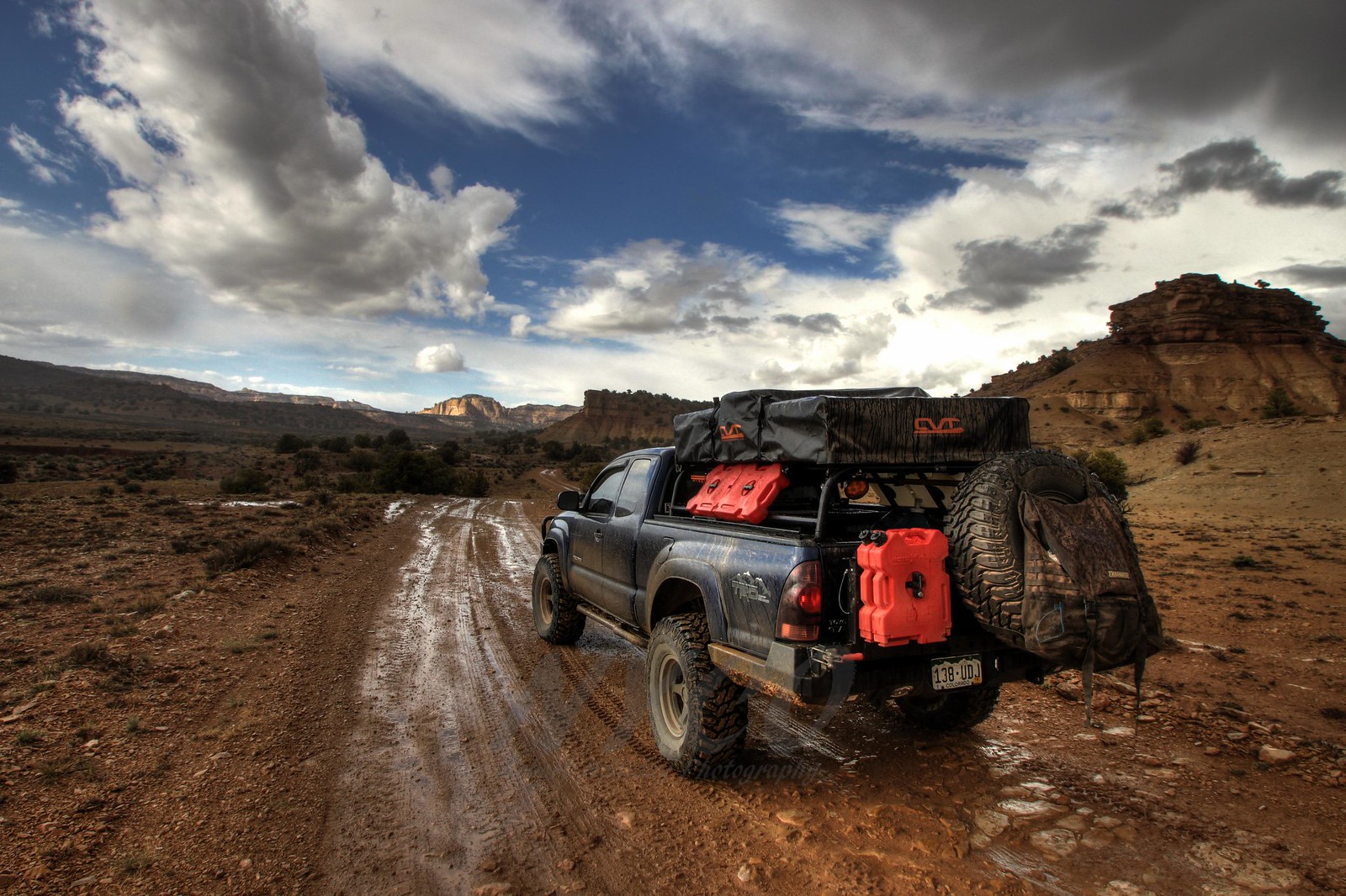

My 2008 Tacoma
is at 106k miles now (I put 52k of those on it!).
The suspension is getting a little tired, now, so I am suspension shopping.
I've run OME on my Land Cruiser and on my 4Runner, so I am leaning that direction.
This truck is my 'expedition overland' vehicle , and is also my Daily Driver. So I drive it to/from work with it completely unloaded, but I also heavily load it and drive out on adventures .
The truck is completely stock except for some CBI offroad sliders I put on it a few years ago when I bought the truck.
The plan is to eventually add:
ARB Bull Bar w/ 10k Winch
CBI offroad rear bumper with swing out (or fabricate my own ).
BudBuilt Skidplates (or fabricate my own).
Thing is, I need to replace the suspension before I can afford to get any of the above items.
Normally, the choice would be pretty simple, put on an OME light kiton it and be done with it, however, when I load the truck, I am taking a 'kitchen' box (100lbs), Camp Chef dual burner stove, Coleman Free Piston fridge, 10-15 gallons of water, 10 gallons of fuel, camp chairs, full camping gear (tent, sleeping bags, clothing, pads), 127mm aperture telescope andtripod/mount. I haven't figured out the total weight but I'd guess it's easily 500lbs+
I am not interested in replacing the UCA's unless there is a good option that retains factory ball joints. Reason for that is because while the Uniball's are stronger, I drive this truck in the winter (skiing, commuting, etc) and they salt the roads here. everybody I know who does Uniball UCA's ends up having to replace the uniballs every year or so. -I am not interested in doing that, therefore, no uniballs.
Primary uses are commuting unloaded, but also bombing down dirt roads in the desert at Mach:RETARDED while heavily laden.
I am thinking about getting the OME light kit, and adding a set of Firestone airbags.
Any thoughts on this?
