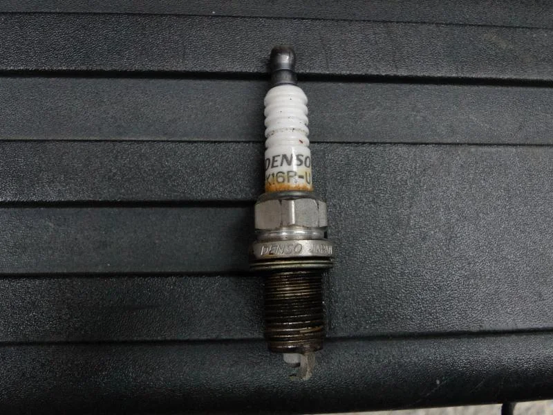

I am periodically smelling a sweet smell from the exhaust. So I will be renting the block test kit from AutoZone to test for a leaking head gasket.

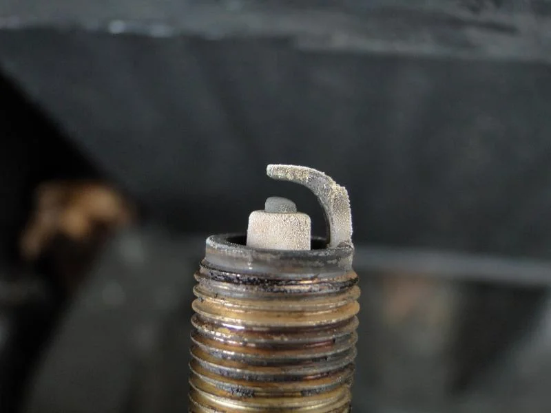

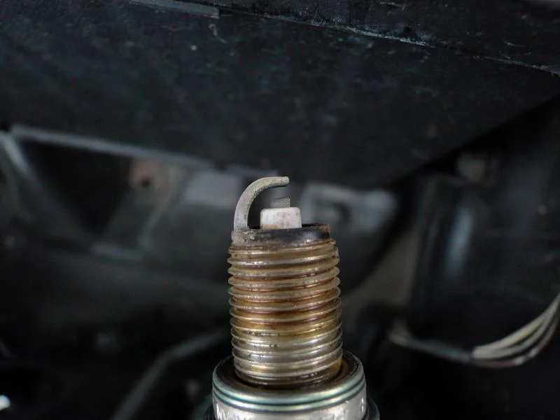

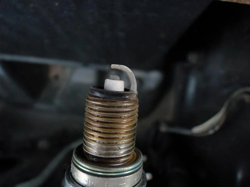

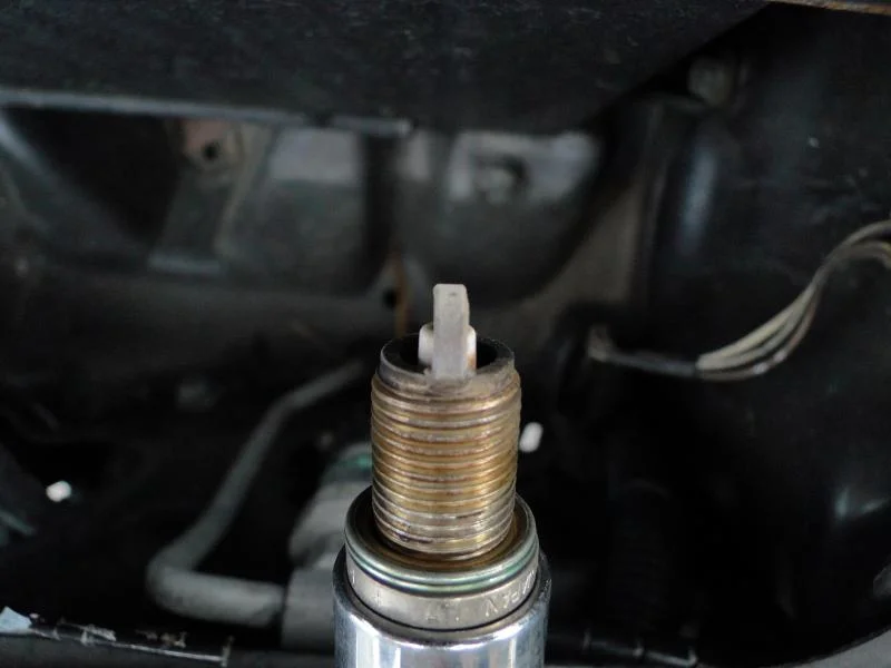

I have never had a vehicle with a head gasket leak that wasn't immediately apparent. So I pulled spark plug #6 and #2 (for comparison). I would have pulled them all, but didn't have time. There are no visible leaks that I can see. Any preliminary input would be helpful.
#2
#6 in next post
Some may have experienced a "sweet" smell from coolant infiltration into the combustion chambers, but I've never had that experience. In my opinion, you'd have to be losing a copious amount of coolant in order to actually change the smell of the exhaust, and by that point, there should be enough steam being produced that it should look like a nuclear power plant cooling tower :) Have you noticed a rise in your coolant temp. or a drop in your coolant level? Those would be the first two places I'd look. Also, check for coolant leaking from hoses......don't assume the sweet smell is coming from the exhaust.
Also, do you know the age of those plugs? They appear to be the correct color, but they also look very worn! Recently, I changed the plugs on one of my 80s (one with 188,000 miles) that had had the engine rebuilt. The guy rebuilt/changed practically everything on the engine, but apparently he didn't bother to change the plugs. When I replaced them, I would not at all be surprised if I found out they were original! I had started to develop a slight miss, so I decided to do a really good tune-up. I replaced cap/rotor/wires/plugs. When I pulled the plugs, they looked much like yours, only a bit worse (all six had about .070 gap, when they're supposed to have .031!) In any event, what I'm trying to say is, your plugs look very worn to me. replace them, and see if anything changes.........I can tell you, mine runs like a different truck! At the same time, look for any weeping of coolant from any hoses, heater control valve, etc. Hopefully, you'll find a different source for the smell you mentioned...............
