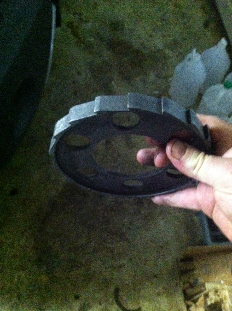

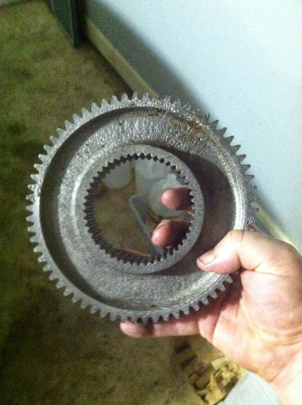

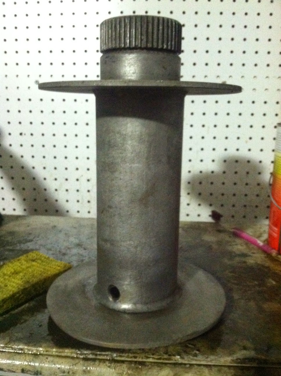

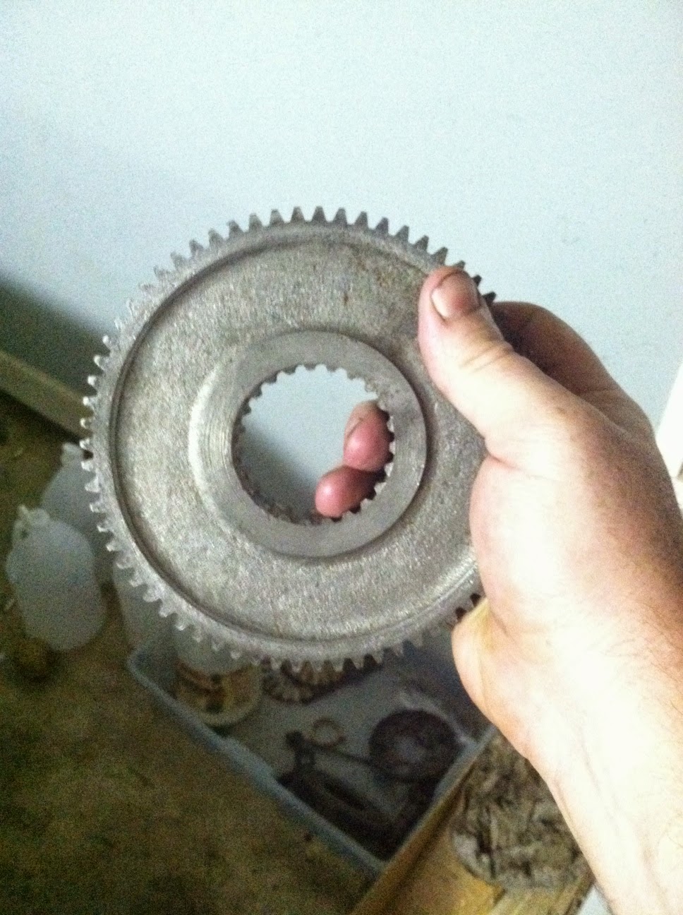

i'm rebuilding my grandaddy's 8274. it's been sitting in my uncle's shop for 25 years. when i opened it up, the gears were absolutely covered in rust and the spool was seized to the main gear. I was finally able to get the spool out using wooden wedges and a BFH.
I've had really good success with apple cider vinegar to remove the rust from the gears, the brake ratchet and the spool.
I plan to paint the spool and brake ratchet with gloss black implement paint and the casing and brake discs with the Plastikote aluminum color paint referenced in flintknapper's rebuild thread. I'm wondering if i should paint the faces (but not the toothed edges) of the gears to keep them from rusting in the future. any thoughts?
thanks in advance.
