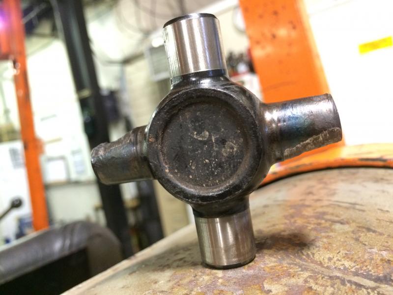

1. Replaced a worn-the-slap-out-can't-believe-it-still-worked U-joint. It just started making noise last week. It was a non-greasable unit and these two caps were just full of rusty dust.

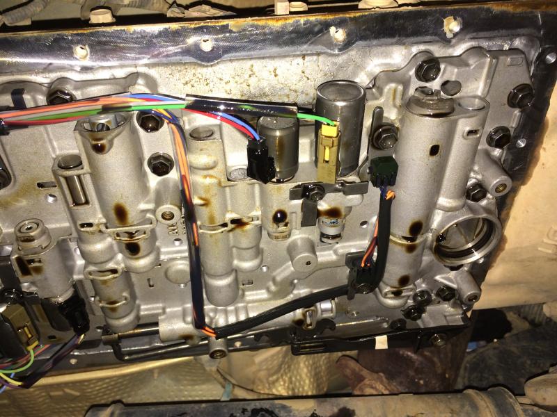

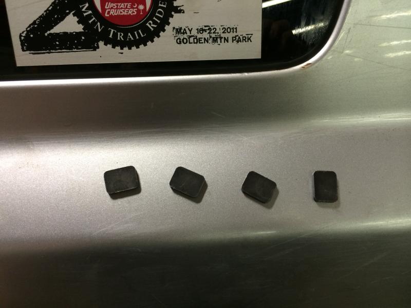

2. Dropped the trans pan, cleaned the strainer & magnets, replaced 5qts of synthetic WS type fluid. Immediately cured my shuddering.

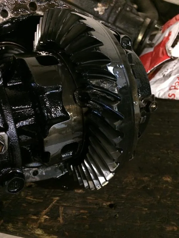

3. Discovered my rear ring gear is toast again (appx 6 months old)!! Not happy at all about this. Been on exactly 3 wheeling trips since these were replaced: SCC at Superlift and two events at Golden Mtn Park.

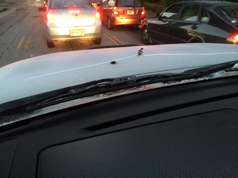

4. Front windshield played connect the dots this morning with the sub freezing temps and a strategically placed pothole. What was once two star-cracks is now a continuous crack running across the bottom of my view.
