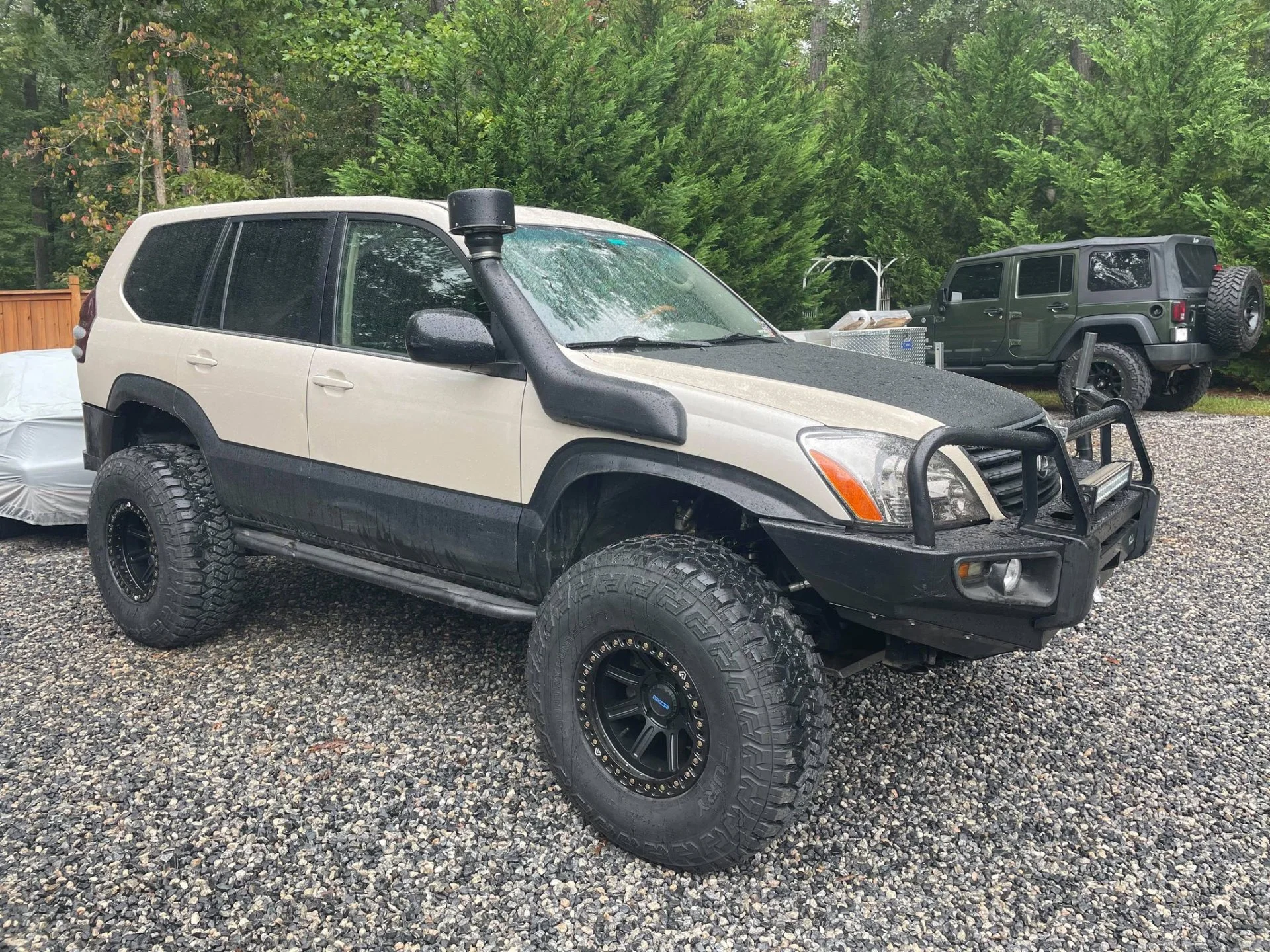

My GX saga!
Complete:
2 x Icon 2.5 Long Travel Coilovers
2 x Total Chaos secondary hoops
2 x Icon S2 secondary shocks
Poly Performance Alignment Plate Solution
4.88 gears front and rear
Diamond custom hybrid rear housing
Panhard Relocation Kit
Nitro 9.5" rear differential
ARB compressor
ARB front and rear lockers
Icon Front and rear Jounce
Welded in Total Chaos beefy cam tabs.
2 x 4" long travel slinky springs (1000-1200#)
Califab rear upper and lower arms
2 x rear GXOR Slinky Icon 2.5 omega double bypass remote resi long travel shocks
1 set RCI skids
1 x Iron Man Prado front commercial deluxe bar
1 x Iron Man Prado snorkel
1 x TopSpin HD Precleaner
1 x SmityBilt X2O 12000 winch
1 x Califab Panhard rod
2 x Rear brake line extension
1 x full LED kit from PFRAN LEDs
1 x ipadholdr.com GX470 mount and iPad holder
1 x Custom Alpine/JL audio stereo with Ipad integration
1 x Kenwood 50W ham with bluetooth TNC unit
1 x ARB Twin
Ceika big brake kit (rear)
Wilwood big brake kit (front)
Remove flares and bed line flare pattern, clearance fenders as well
21" light bar to front bumper
Offgrid Engineering dual battery system with 2x G35 Odyssey
SPOD electrical management w/ BT switches (phone, ipad, and physical backup)
ARB drawer system
MSA 4x4 drop down fridge slide
ARB 63Q Element fridge
ACC custom rear bumper with swing out tire carrier
290A HO alternator
2g cables from alternator to battery
bluepitbearing wheel bearing update
ARB power system for the fridge (screw in plug)
LRA 33 gallon aux tank with remote monitor and xfer switch
Nomad valve body with torque converter lock up switch
Lensun solar panel with MPPT controller for the roof (vinyl first, then tape and seal the panel to the roof).
Doug Thorley long tube headers, Vibrant Performance 2.5"-3" GESi cats, 3" Stainless all the way back (including the vibrant performance muffler)
Added a 1/4 wave tube pre-muffler to kill highway drone
Scheel Mann driver and passenger seat on planted technologies custom brackets
Flush mount 7/4 hitch wiring and a dedicated flush mount 50A anderson connector on rear bumper for trailer charging
VSC off switch hack
Marlin front 2.75" RCLT, steering rack, and RCVs
4.88s
37x12.50R17 Fury RTs
Koyo full aluminum radiator with no trans cooler
WAT external trans cooler
Alpha Equipt beadlocks

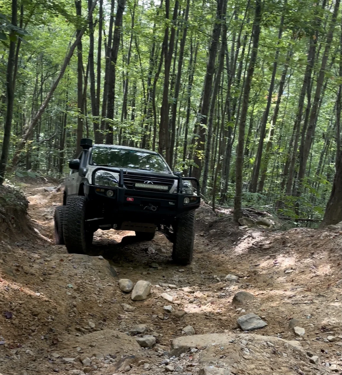

Yep! We go next weekend and the weekend after that. I will share a whole lot more then. This is a full replacement with real coils and shocks all around...including completely fabricating the rear spring system. It also has a full skid plate system made of aluminum and some really amazing one of a kind sliders with some MAJOR beef to them.

Phase II for the GX will be even better...front bumper, dual batteries, winch, snorkel, and some other odds and ends. Just have to save up!
I replaced the front coils and shocks with Iron Man 4x4. The front upper control arms are Total Chaos.
