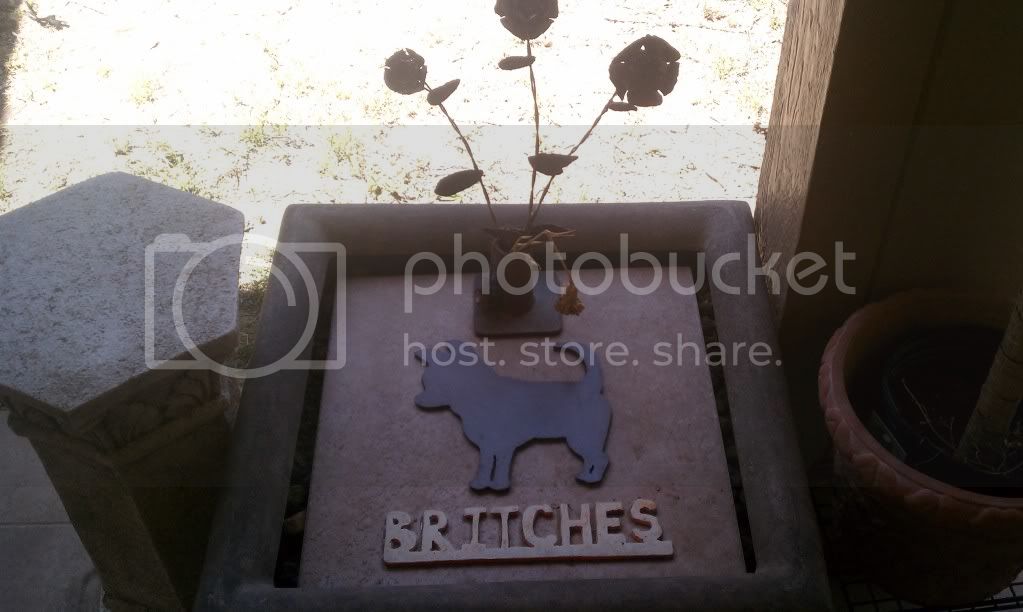

    I tend to dabble in metal art. I haven't done much besides people's names cut out of 1/4" plate. Although, when my puppy of 17 years passed last year, I made her 3 roses that would never wilt. I believe it was 18 gauge sheet, 6-layers deep, a few petals made out of 1/8" hammer forged on an anvil, and stems from 3/32 308l tig filler wire. I'll see if I can get a picture.

    I found a puppy picture of her, as well as how I wrote her name when I was 10. I made several copies enlarging it every time, and the ex made the outline for her more bubbly and 'puppy like'. I then plasma'd them out.
    Roses were all done with a torch, I feel I have more of a connection with something using just a torch than I would with plasma/tig.

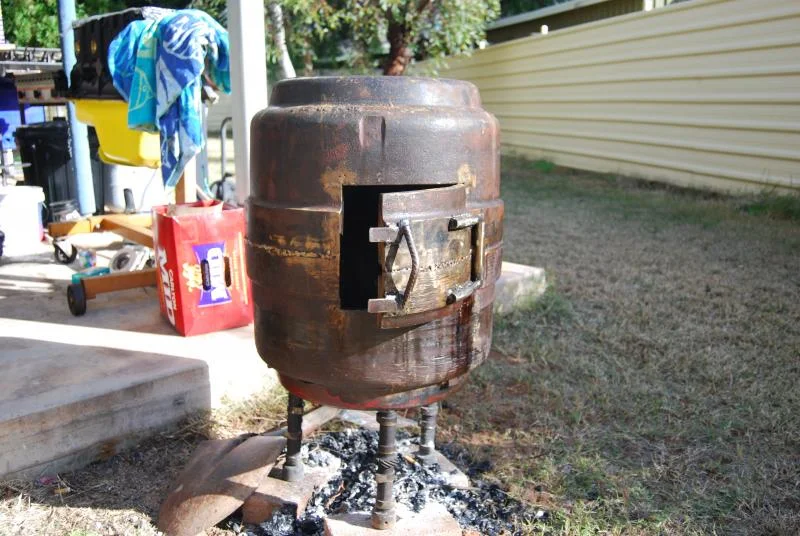

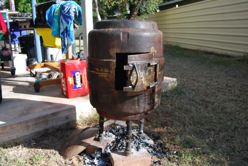

    I make fireplaces out of truck brake drums...the legs are the old cam from the fj45. I cut the door with a 1 mm 4 inch grinder cut off disc.
