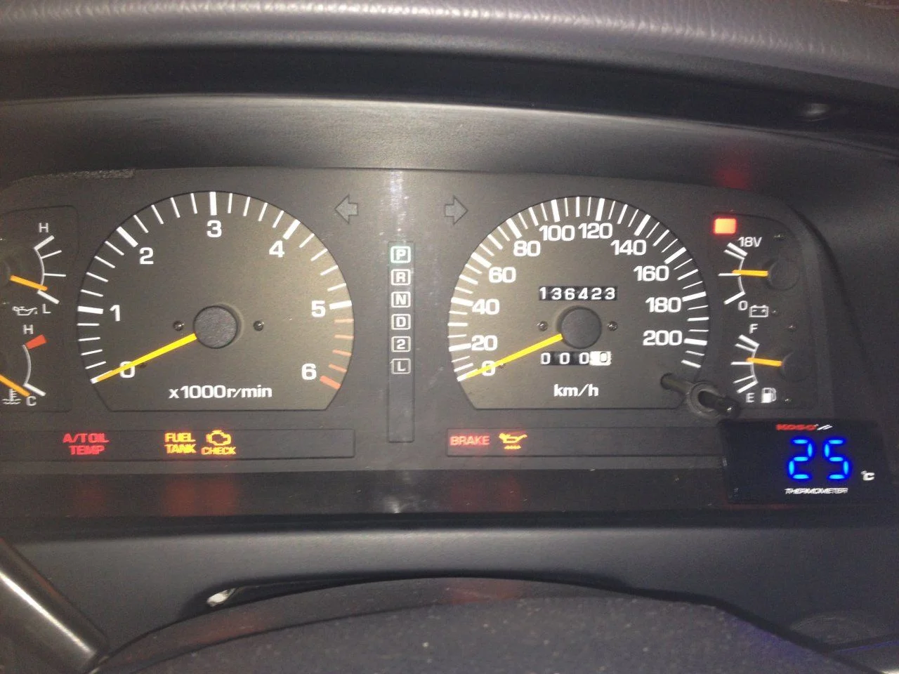

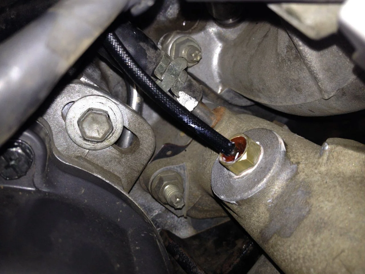

What the "fuel tank" light? Never seen that before...just added my koso gauge..love it thanks @half k cruiser great idea..i got my gauge in celsius,and it sits around 86c in the city..only complaint was the wire wasn't long enough to reach .and i had to extend it..also the sender i got with it was not a tappered 1/8 npt thread..so i tapped it with 1/8 bsb..and used plenty of thread tape+ sealant View attachment 1015685 View attachment 1015686
Yeah low fuel light .. Australia modelWhat the "fuel tank" light? Never seen that before...
