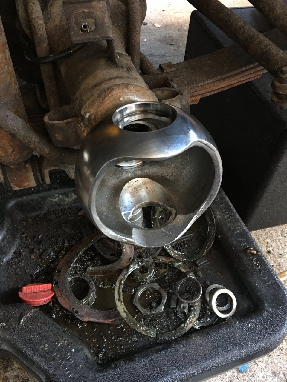

Ball is cleaned and inner axle seal is in. I've got all the small parts from this side ready to go in the parts washer tomorrow.

I hate replacing the inner axle clip on the birf, but I still disassemble it. I don't think you can get all the old grease out if you don't.
I'm willing to separate the bifield and repack it without completely disassembling it. That's a good compromise.
When you separate the axle shaft from the birfield the inner clip breaks off/apart and stays back in there behind the cage. If you go this route make sure you have all the pieces out. If you've gone that far I recommend you just pull it all apart, it's really not that much work especially compared to the entirety of the knuckle rebuild. You'll probably spend just as much if not more time trying to clean it without disassembling it than to take it apart and clean it with everything opened up.
