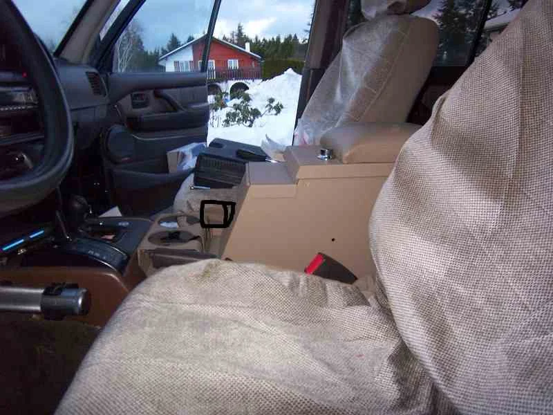

Here is what the console looks like, completely installed (pardon the mess ):
I'm still on the hunt for a set of LX450 seats, but when I find some this will be a great match.
