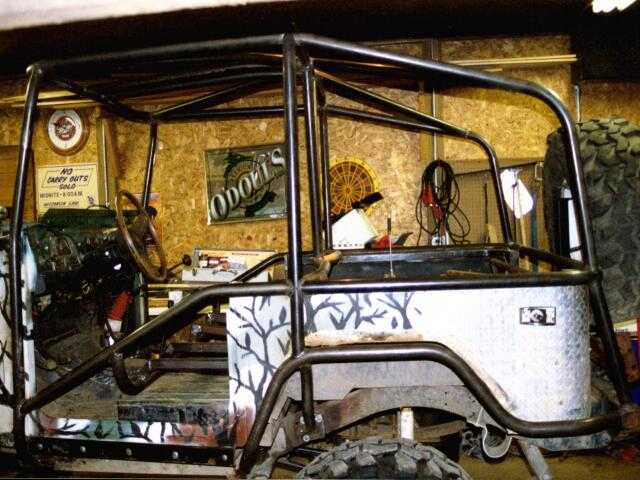

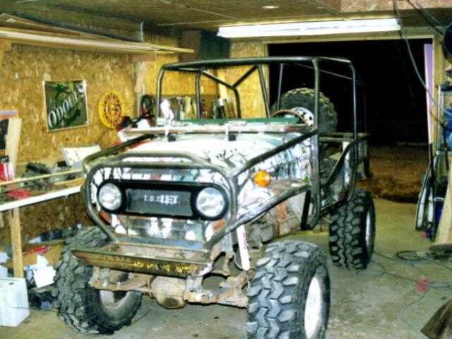

    Could do like I did on my old rig, went full exo cage. I kept the tub, but you could use a simular cage design and leave the tub out. I would make the front hoop go right into the firewall instead of outside it like the exo. Also I made the fenders out of cage material and just capped with cut down stock sheet metal. These pics will give you ideas, just build it where the tube used to be and not outside of it.
    [​IMG]
    [​IMG]
    The write up is still on my site onder modification and I think is still linked on the tech links here.

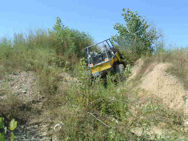

    The photo only shows the rear of the FJ40, but this one is cut directly behind the seats so he can have functioning doors. The owner is Rob Wicket from Iowa. Just another idea.
    [​IMG]

    The pic of the yellow rear looks cool and interests me cause he was able to keep the doors. I like running doors for some stupid reason.

    Yeah I had a bit of trouble with that rear spring until I limited the travel of the shackle. I don't remeber if I had the exo-cage then. Well that rig is gone now, and I'll miss it until I get the new one done.
