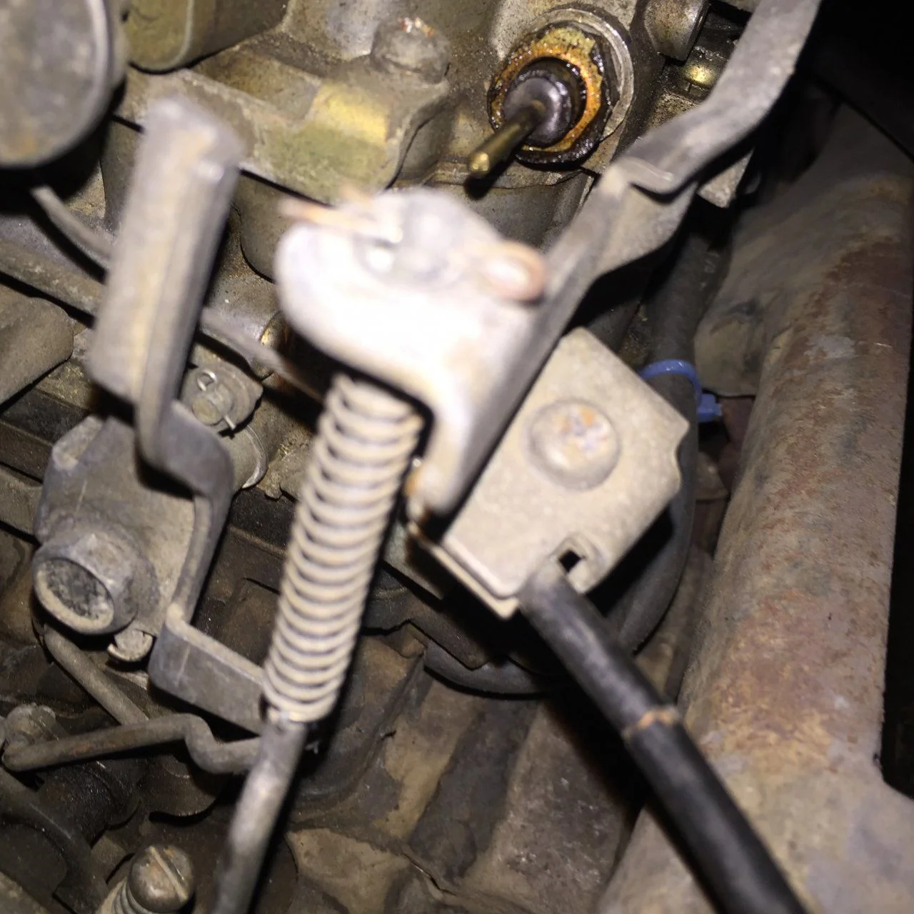

First item checked was the idle solenoid.
And it looks like it's screwed in there but the housing and anything connected to it is gone.
If I'm correct in thinking this is it.
So I believe then I would be getting fuel from another source then? And maybe that's why it's just kind of dumping/spraying in there instead of something more regular?
Ding! Ding! We have a winner! Your IFS is toast. Carb is probably just dumping fuel past the solenoid. Get a new solenoid. Hook it back up and re-tune using the lean drop method. I wonder what in the world happened to that thing? It looks really crispy.

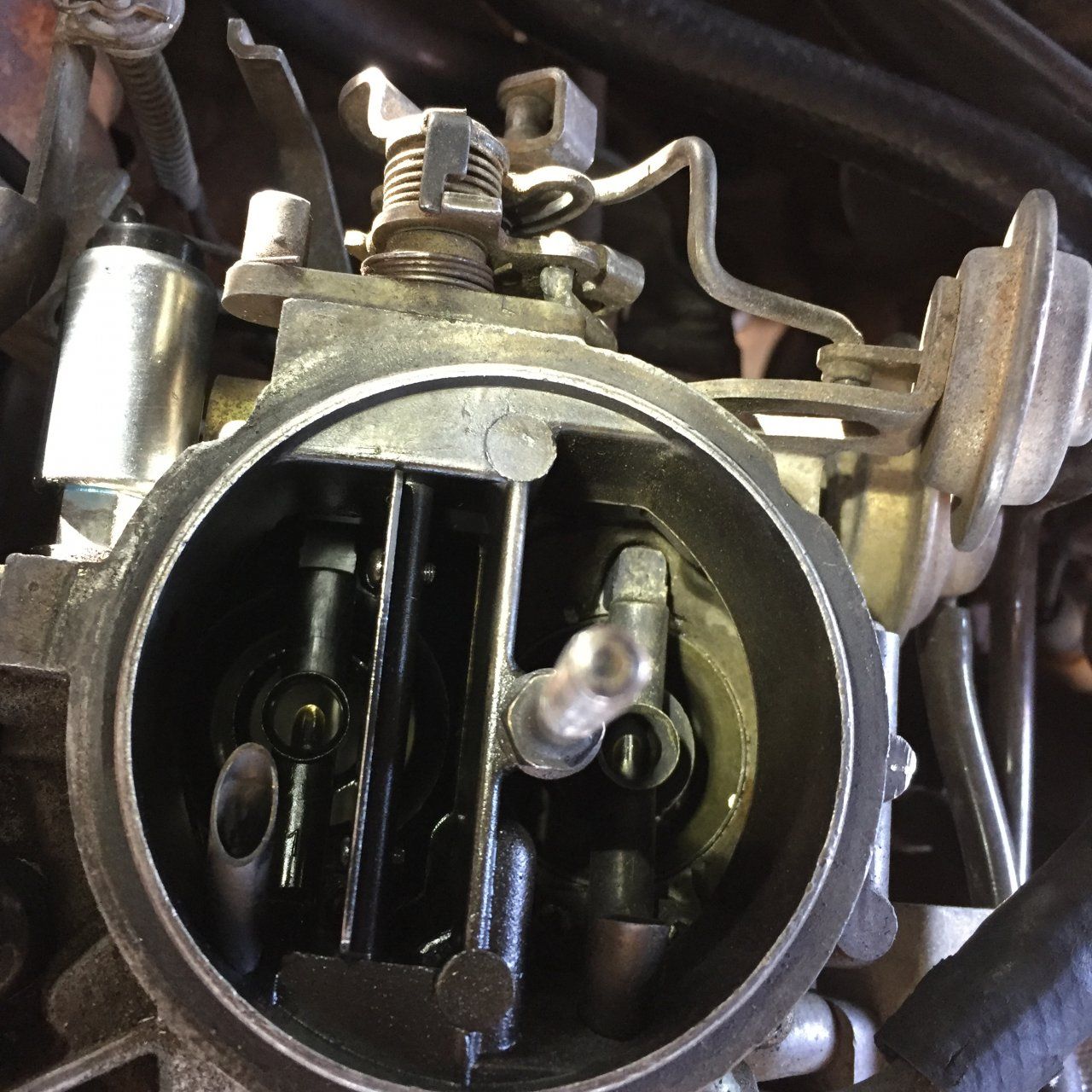

The secondary looks pretty dry from the inside. And slowly revving up the engine to about 3800 rpms the secondary rocker arm thingie never comes in contact with the throttle linkage. I know my technical jargon is off there. It hopefully that makes sense. Hard to tell from the pic but the secondary cylinder just looks dry. And this truck has been used on the highway with frequency.

For the secondary, my understanding is that it should be dry as it is only used in high load situations (e.g. freeway driving, going uphill, etc.). There is documentation to test that your ICS circuit is working properly but basically, you should be able to have the ICS unplugged and turn the key to the ON/RUN position, not actually start the engine though. When you plug the ICS in you should hear and/or feel a significant CLICK come from it. (hopefully that makes sense). Try that test and let us know what happens.
