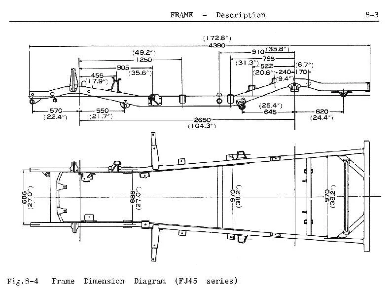

looking at some of my old downloads came across this.
The question is, is this a 45lv or a 45lwb pu frame dimension.
I am going to extend a 45lv frame to make a 45lwb pu frame. I dont have acess to either of these or I could take the measurments and find out.
If this is not a lwb frame does anyone have a good drawing showing the dimensions?
