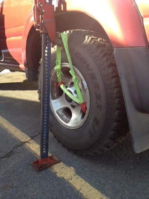

X2! I understand what you're trying to do and it looks like a very economic way to get it done. But, the phrase "You get what you pay for" keeps popping into my head when I see this. Just remember your words: "a parking lot is the perfect senerio". It will be different in the woods.That scares me !

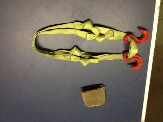

Having a bit of experience with webbing I can say that its more than strong enough even with that little 1 inch tube webbing that your using. I always keep about 20' of this and some carabineers with me for whatever. The only thing I don't like is it sitting unsecured on top of that piece of fire hose. Yes, the wheel should stop it, if it did slip forward. But, it could also slip down between the tire and the point of the jack and F you pretty quickly. Probably wouldn't be to difficult to rig some sort of metal pin type keeper for it. However, having just looked at the lift mate on Amazon, they are priced pretty reasonable.
You could easily modify that setup to be stronger and more stable. Instead of doing that double loop over the top just do a single knot around one of the hooks. Then on the other end of your webbing tie in a loop that you can fix a carabineer to. When your ready to use, feed the free end through the triangle under the lifting arm of the jack, then attach the carabineer and 2nd hook for the lift. Yes, it will bring you down to single wrap, however, the current triangle that your webbing creates under load is causing your hooks to load from two directions. By going a single down to each hook you will keep your resultant forces on one plane and actually put less stress on your hooks.
