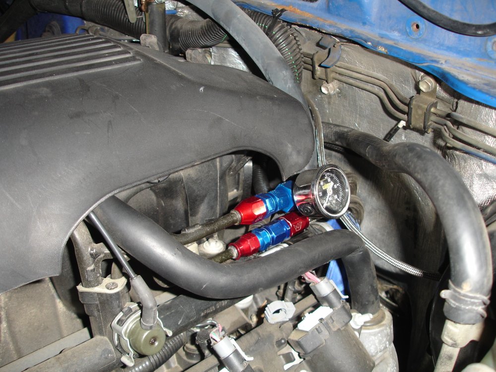

As far as regulators go, my understanding is that you can really run whatever style you like- the Vette filter with integrated regulator and the dead head rails with no return, keep the regulator at the rails like you have now, or any other configuration you like. I'm assuming you don't want to replace your rails, nor would it be necessary for a stock 5.3 motor, so the route you chose is probably the easiest and least expensive.
Symptoms: Louder than normal whine at idle (much louder), the pitch of the whine varies significantly with gear and RPM, loss of acceleration (for some reason especially lower gears), stalling, and then after all of these finally no starting until it's sat for at least 30 min. But then, the next day it will run like a top, though overall the whine is louder than normal. Like I said, the pump may have gone prematurely due to a bad FPR, old filter element or it was just a s***ty pump. On the stock 5.3 it has supplied fine as far as I can tell.
I have the fuel filter element and the FPR replaced, but I'm still waiting for this fuel pump from Bosch Fuel Pumps (which is one of the order fronts for Inline Motors in LA...). I FINALLY got an email from "Sheri" who instead of giving me the model number and specs for the Walbro pump they want to sub for the Bosch like I asked, simply told me that it will "fit just perfectly" and that she would send it right out. Did I mention that BOTH the phone numbers for Inline are disconnected? Luckily, the transaction was done through Paypal, so I have recourse if I don't get the pump or it's junk or a model that will not fit my application. All of this sucks though as I don't want to run the truck until I get a new pump in there.....
