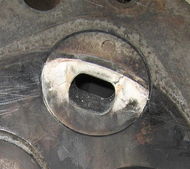

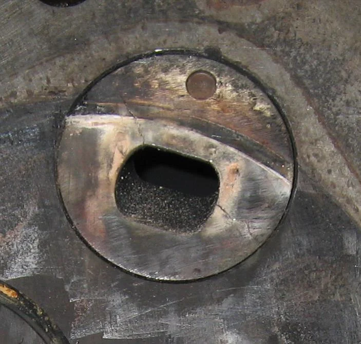

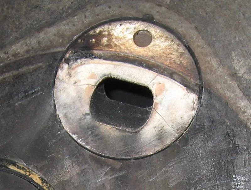

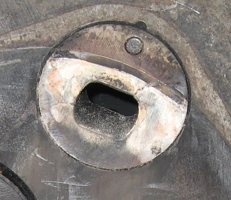

    The tightness in the head is definitely not the limiting factor - the cups sit only halfway over the cylinder, the rest is squished against the block, so they're never coming out if they're whole...
    ... IF they're whole. If they rack all the way through, you'll end up with an engine looking like David's ^^.
    Always replace precups.
