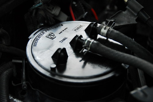

I think that's either protection for a battery cable or a hose for the shower heat exchanger.Ken,
What's the heater hose going to your battery box?
Won't the CC now breathe though the hose and saucer?I modified the new CC by drilling a hole in the bottom cap and screwing in the OEM CC's swivel breather tube that routes down under the engine.
Ken,

I hope this works on my '93 as i found out yesterday OEM cansiters are now unobtainium. Ordered one and am keeping my fingers crossed.
