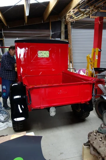

Just plain ugly Fouad? Heck I actually like this look:
A shortened/widened model-T type rear would sit well on this I reckon:
And tasteful sweeping guards, running boards and massive rear tyres (perhaps even dualies).

Regarding the actual lowering process...well...let me just say that the decision to go low was tempered by a need to not go SO low as for the car to become a pain in the a$$ to drive. There was discussion on air-riding the car...installing air bags that could raise and lower it...which I immediately dismissed because it would compromise on the handling of the car. We had lots of back and forth on lowering springs. Frame flips. Shock tower adjustments. There was also much discussion on how we wanted the car to eventually turn out. The Deuce - venerated '32 Ford - was the OBVIOUS example...
Nope. "No air bags", said I. "No fancy stuff that will make it less of a pleasure to hoon around. And as for the looks? Well...why not make it look completely unique?"

Professor Hafeez - What type of springs do you have in your windshield hold down clamps? Something looks a little skewed between the height of the windshield and the location of those hold down clamps.......;)
When it comes to thinking outside the box with an FJ40, let's just say, At times, it appears you never, ever started in the box. :idea:
Nice creative work you got going over there.
Thanks for the appreciative words. Actually, with such a steeply raked back windscreen, we didn't want to make it even capable of moving around, so it's not a fold-down screen at all. It's bolted down, fast. And has just two positions: the one you currently see, and one where it's removed completely.
