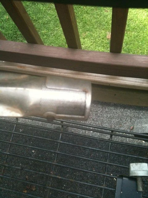

    well people i have successfully done it. If you want your grill to get around 800-900 degrees here you go....
    1. buy new regulator
    2. drill all orifices out to 1/16th - they are very easy to get to
    3. open your baskets to allow as much O2 in as possible. This will tweak the gas/air mix so that your flame is not yellow....you should get a big blue flame with just a little flickers of orange.
    Step three was the step i was missing to get it perfect, but i talked with a Weber rep about adjustable regulators and he suggested i try the baskets first....worked perfect.
    here is what they look like. there is a screw that you will have to loosen before you can turn them.
    now my grill gets over 800 degrees ... booya.

    Nice illustration.
