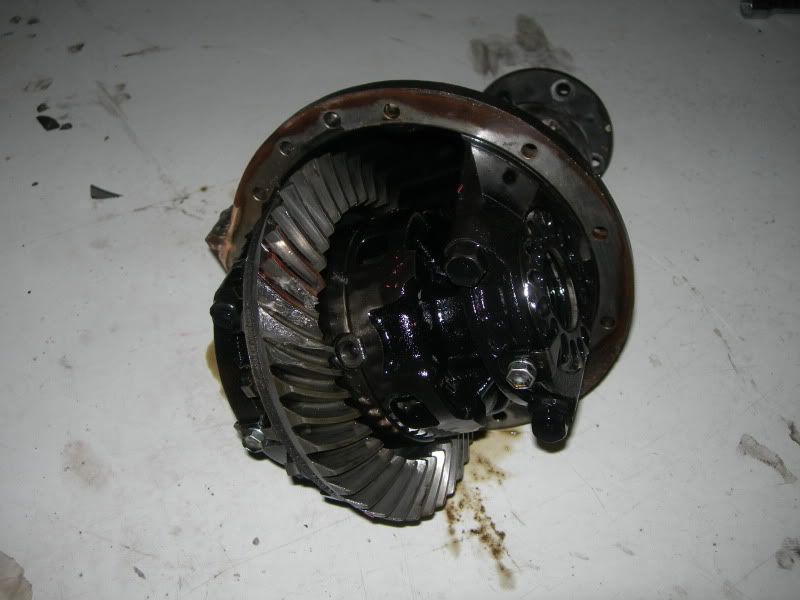

    I think it started with 3 one tooth. By the time i tore it down it was 3 teeth. I did however put them under my pillow and received 4.56 gears from the diff tooth fairy:D
    [​IMG]
    [​IMG]

    I'm surprised it took you this long to break 'em Don. I've gone through two rear R&P's and one front one. Going 4.56 when these go:D
    My first one looked like this after hobbling off the trail.:doh:
    [​IMG]

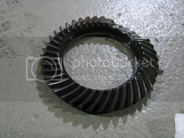

    I drove home from Moab 1,500+ miles and then some on this ring gear (note that it has broken teeth in three places):
    [​IMG]

    Did you know that it was broken at the time? My trek off the trail was only a few miles, but even at 5-10mph it was like ga-ga-ga-ga-ga-ga-ga-ga-ga-ga-BANG-ga-ga-ga-ga-ga-ga-ga-ga-ga-ga-BANG. Once we got the ring gear out, we drove home in front wheel drive (auto tranny, t-case in 4-hi), which was an interesting experience too.
  10. 1911
    1911 chupacabra SILVER Star
    Messages:
    4,005
    Likes Received:
    747
    Joined:
    Aug 11, 2006
    Location:
    Parker County, Texas
    Yeah, it was pretty obvious - a distinct rhythmic whine especially in low range. Wheeled it another two days, drove home as said, and around town for a while until it started to clack, then drove it 30 miles to the dealer and back home again, then it was finally time to tear it down. :) I'm guessing that the biggest chunk of missing teeth didn't break off until it started to clack, but it still went at least 60 miles after that.
