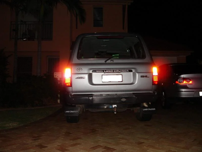

    Here's a night time shot - I can post a dy time shot later when the sun comes up over here in Australia :)
    This photo is Mot's Clear/RED LED Tail Light with Yellow globes for indicators and LED Replacement Bulbs for Reverse Lights.
    The tail lights were on in this pic(not brakes) and Reverse and Indicators...
    They are all very bright..

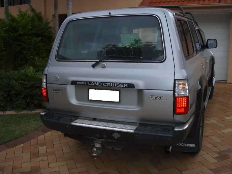

    Here's the day time shot you were after - they are more of a dep red color - the camera seems to want to make them more yellowish because they are so bright and it makes them darker than they are with the human eye - this is only park/tail lights turned on - brake lights came out as a red blur... so I am only posting the tail/park light shot.

    Franku, in this picture it looks like your 3rd brake light is out and possibly the reason the system is not working and you just subsidized that bulb with the one you added.

    G'day Landtank, it is definitely working - that photo is without the foot on the brake pedal :)
