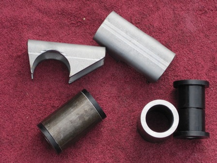

Here is what we have lined up so far for the restoration...
-Full body restoration, being subcontracted out and handled by a guy I know. The body is being completely restored to original condition. Final color will be a shade of green, a stock color. A new soft top canvas is being made that replicates the stock canvas but it will be tan rather then the stock OD green.
-Full engine rebuild, everything is going to be rebuilt and new. The radiator is also getting a complete rebuild. We will be going with an early original engine paint for this which is a shade of sea foam green. No real upgrades are being done to the engine.
-Full suspension rebuild and upgrade. Springs are being made by Alcan, lift will be about 2.5". The Patrol has some home made junk rear leaf hangers and springs. I will be cutting the leaf hangers off the truck and welding new ones on. Shocks are undetermined by we are leaning towards OME. Everything is going to be new int he suspension.
-Full frame restoration. The inside of the frame will be getting treated with Rust Bullet. The battery box which is under the drivers seat will be rebuilt with new steel. Once all frame work is done it will be getting a fresh coat of Dupont Imron chassis black. The truck will be getting brand new engine and transmission mounts that are NOS.
