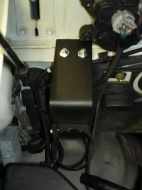

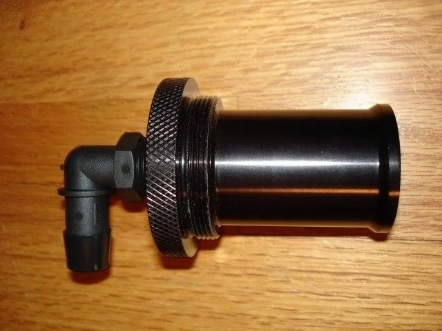

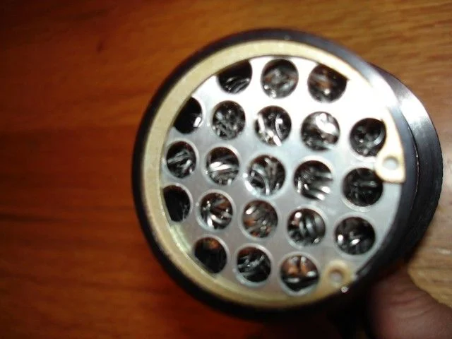

After even more research I decided on the “Accurate Machine Works” catch cans and ordered one with 5/8” inlet and outlet for the turbo air exchange system and one with 3/8” inlet and outlet for the PCV air recirculation system. The AMW catch cans are a wonderful work of art; completely CNC machined for precision and purpose through and through. These are not average catch cans like the Greddy catch can I originally purchased which would honestly do almost nothing to catch the crap our engines repeatedly regurgitate. If yer interested, take a looksee at the setup I fabbedup and tellme whatchya think…

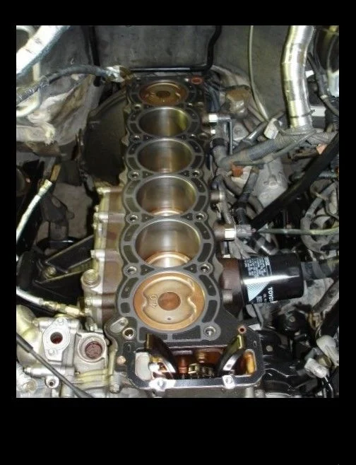

First a foto of the completely cleaned motor sans head...
