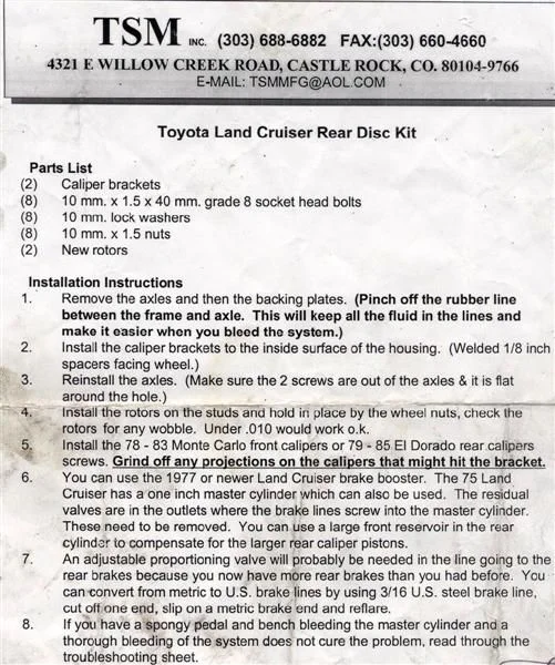

For those who have Disk Brakes,
These are 76 Monte Carlo Disk Brake Pads to go with my 76 Calipers
My junkyard didnt have any 78's
My Guess is that the 76's are not right and i need to go get some 78 Calipers Due to the Fact that the inner Metal Tab is rubbung the inner caliper, and the Pad is not even flush with the Rotor on the outer edge.. Just want to verify this before i go and make a trip and get new calipers..
