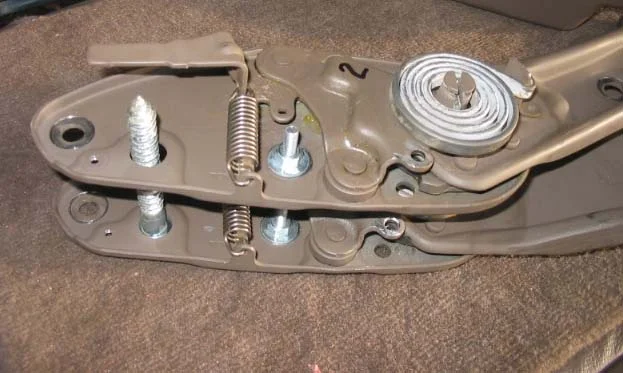

With the recent resurgence in recliner hinge interest, I though I'd provide an update to my latest recliner hinge endeavors.. first assumption is you're already well versed on the original recliner hinge mod, and already know about removing hinges and removing the heads of pins. Second assumption is that you're too cheap to just buy the real thing from Mot, saving yourself quite a bit of time, and minimizing the risk that you'll screw up both your 2nd and 3rd row seats forever.
If you're still with me, here goes. As you know from assumption 1 your 3rd row seats provide the highly sought-after incremental adjustment, after one does the first hinge mod, because of its many-toothed gear. The second rows only provide 2 settings- full erect and full recline. So the solution then, is how do I get the good gear from the 3rd row hinge installed in the second row?

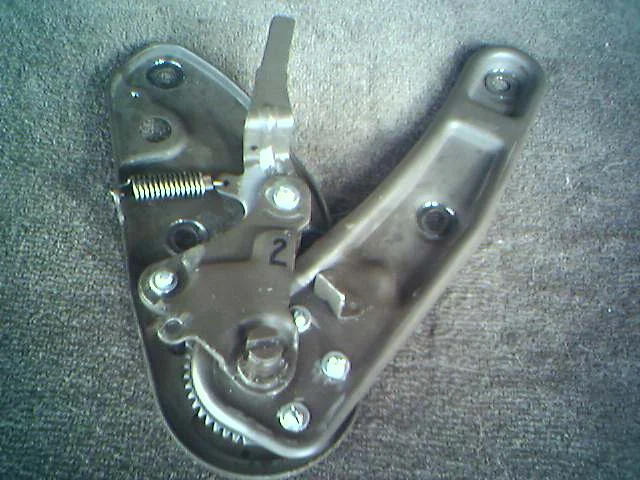

Let's take a look at the hinges. I drew a 2 on the second row, and a 3 on the third row, both are from a RH side seat. Notice how when alighned, the two top sections appear almost identical, the only difference is the bottom "leg" of the hinge, and of course the gear.
