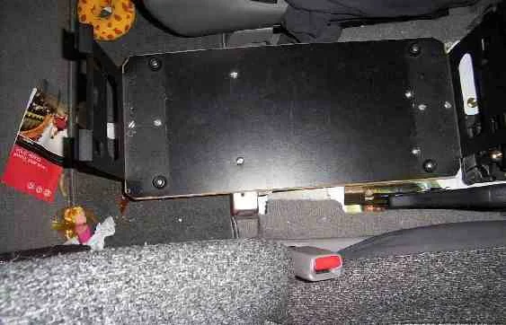

Photo of fridge in place and bracket, I'm into functionallity not cosmetics, so something better could have been done with the brackets, painting, carpet etc, I just cut a piece of 1/2" MDF board and screwed the brackets to it and used existing threaded holes in the existing console bracket and floor pan to bolt it to. There is ample room to access the handbrake lever and also room on the passenger to access seatbelt etc. It is a bit higher than the standard console but I drive with my arm resting on it. My good lady shoves my arm off when shee wants to get into it and the lid hinges up to the rear out of the way. It works brilliantly for us, but others may prefer something more "original". As I mentioned before, 25 litres of cold space holds a lot of food and drink and keeps it very cold.

$513 available from RV lifestyles so you can definately get them, I also have the AC adaptor so we have it running in the house the day before we go and load it up with all the food etc. The mounting brackets ar a bit "ordinary" but I went with them as I didn't have time to do anything else. There is a strap to go through the brackets to lock the fridge in place but I actually slide it down over the fridge over the top of the brackets instead of threading it through, it holds better this way and also does not reduce air supply to the condensor.

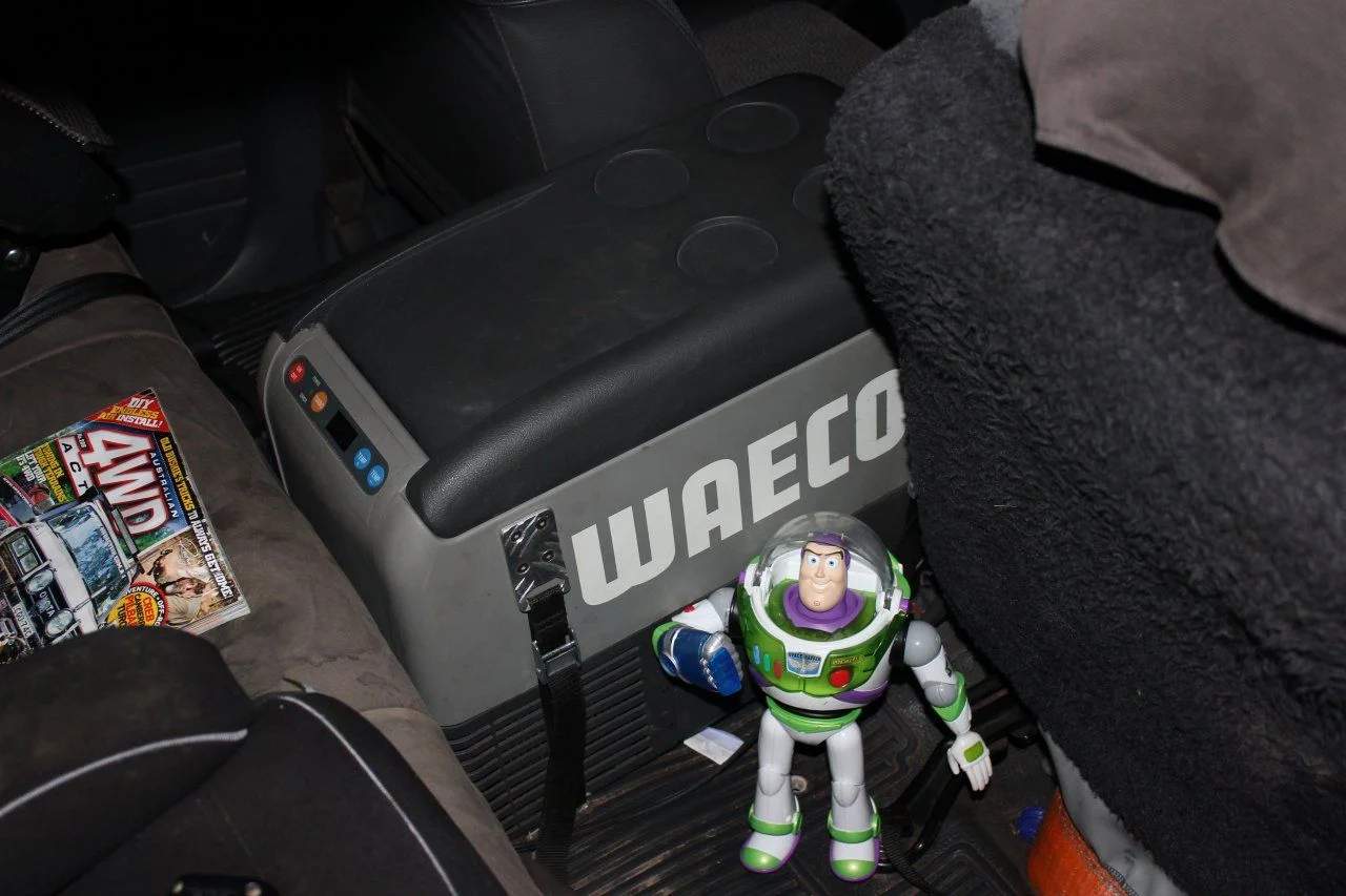

Holy thread revival...... @100 TD How is your fridge holding up, assuming you still have the vehicle? I thought I was the only one to fit one of these waeco fridges as a center console, looks like you beat me by a few years... This is my setup in the 80, wish i had googled mounting kit for them, but this setup is very secure. And you are right, the height is perfect for armrest. http://www.waeco.com/Australia/MS-9...e-Series/SK-115444-CoolFreeze-CF-25-CF-25VERA
Excuse the mess, photos taken after long trip
