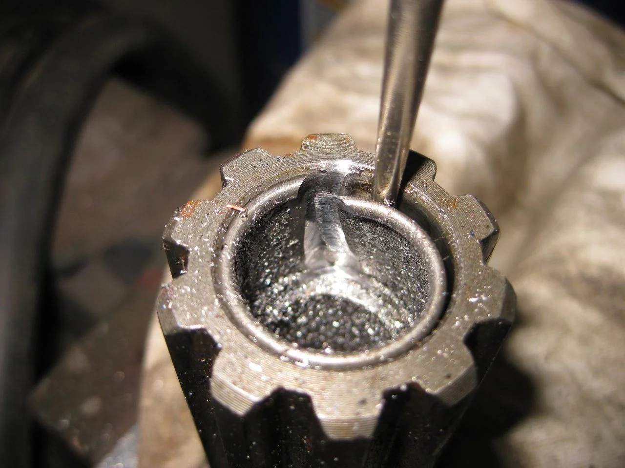

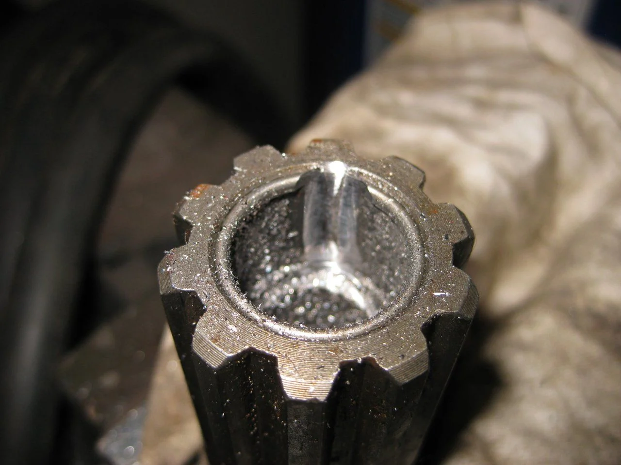

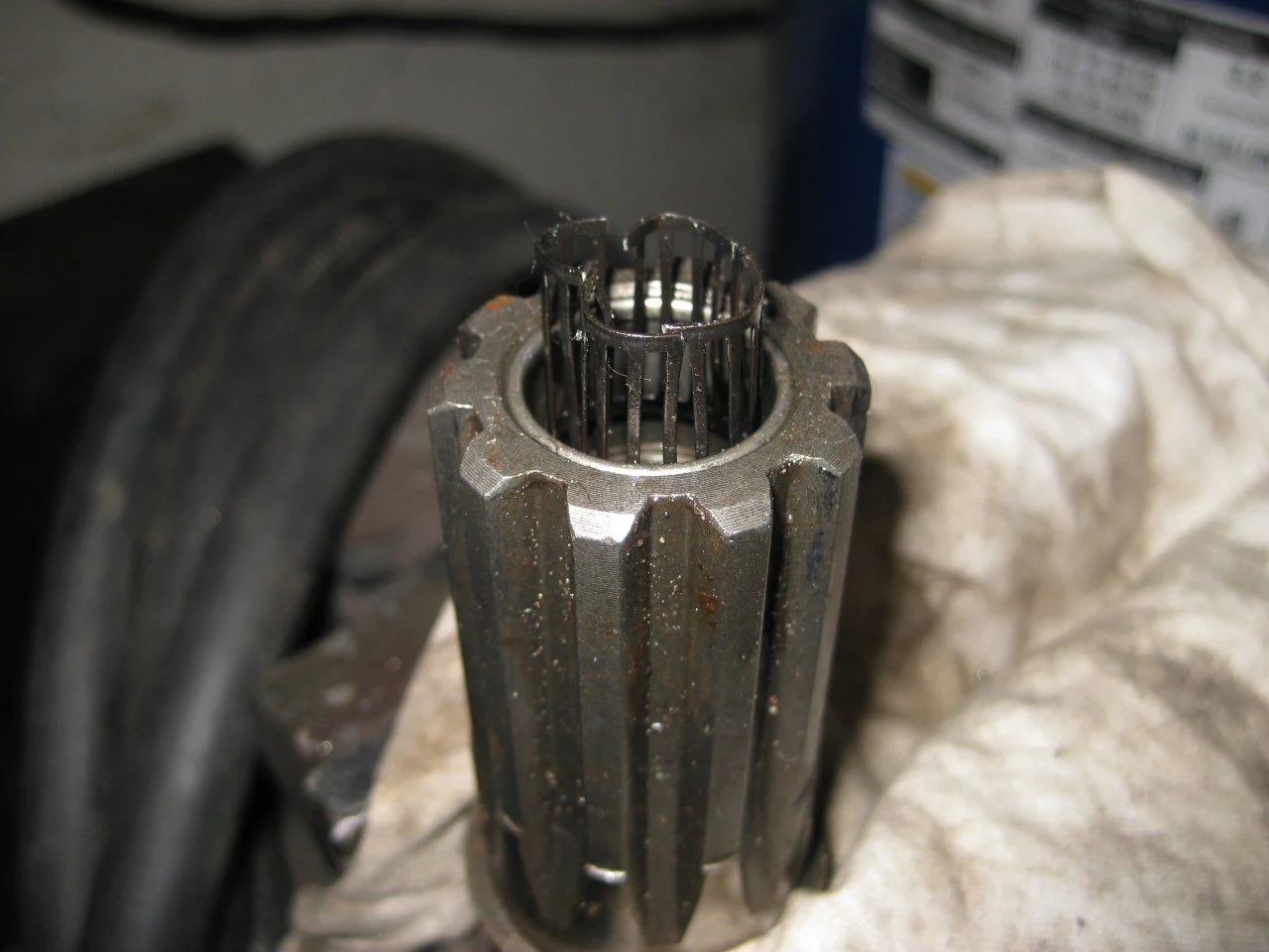

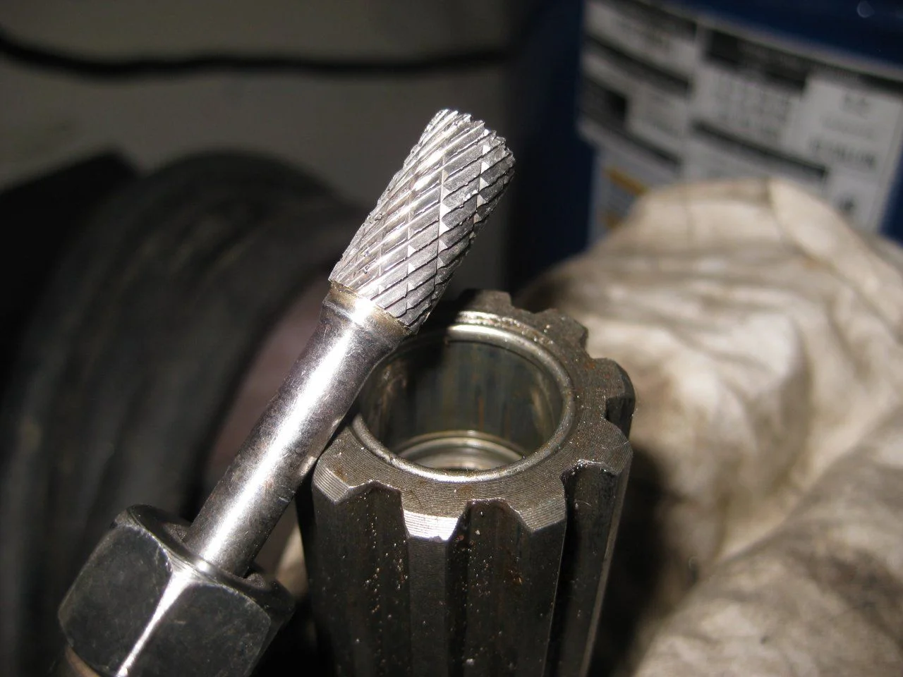

Here's a little technique to removing the output shaft.
Insert bar and utilize internal housing step to brace gear and hit w/plastic mallet

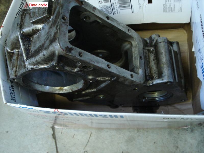

SPARE housing (74?)
