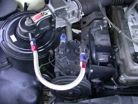

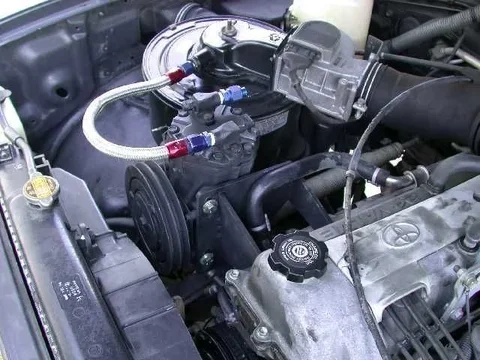

Just got finished making my brackets for the york. Also welded a pulley on the front of the water pump. Plumbed the intake to the air cleaner. Yes I ditched the PAIR valve. Just not enough room for everything. Next is wiring and plumbing. Have a 7 gallon tank going under the rear. So far so good. Also, just a little plug for C-Dan. Thanks for the new gas struts for the rear hatch. If anyone needs these, call Dan!

I used a 5.5" pulley from a power steering pump. No idea what it was from. I cut the center out with a 4" hole saw and welded it to my water pump pulley. It runs straight and true. I'll pm later tonight.

My york was from a junk Ford truck. I rebuilt it myself and did some oiling mods. Real easy stuff. I'll post some good info on the yorks in a couple of days. Out of town for the weekend. Thanks for all the interest in the bracket. Back at ya monday!
JK, that is correct. Model 210L. It put out a lot more air than the others. Easy to find at the local junk yard. I did take mine apart and clean it. The clutch bearing was froze up. I soaked it in PB Blaster for 3 days then greased it. Runs smooth. The local auto parts wanted $56.00 for the bearing! Usually the clutches are not bad, they just need to be taken apart and cleaned.
