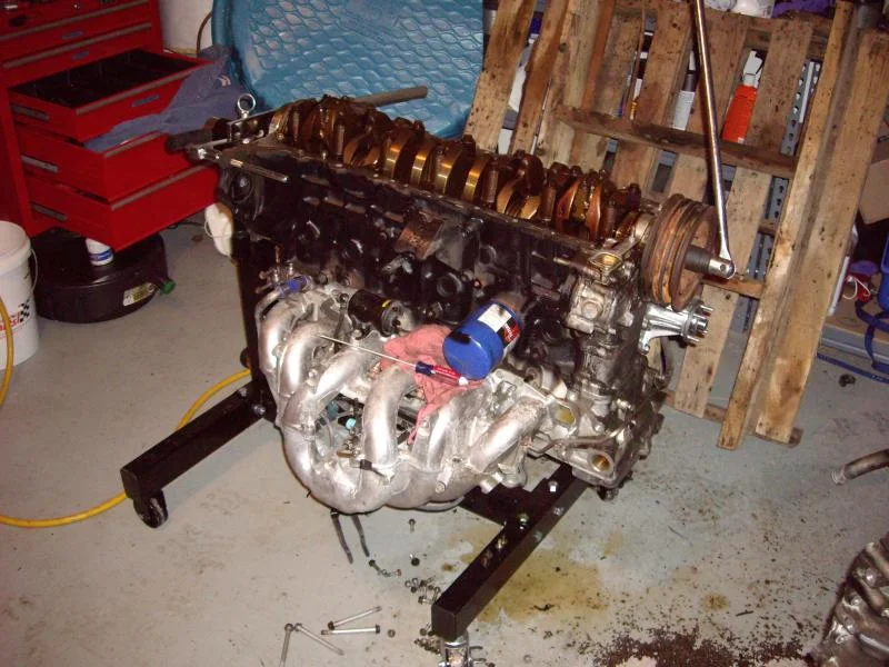

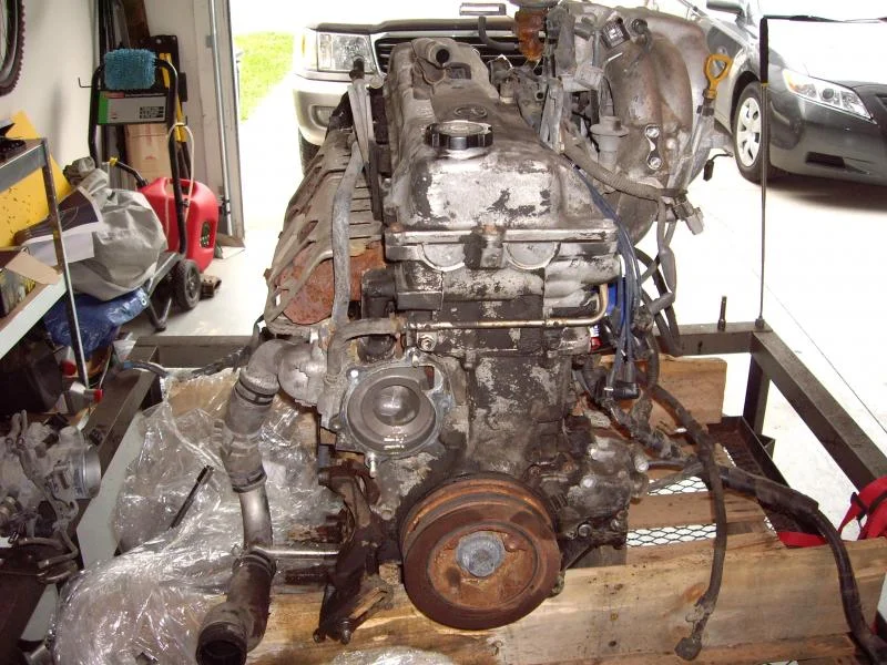

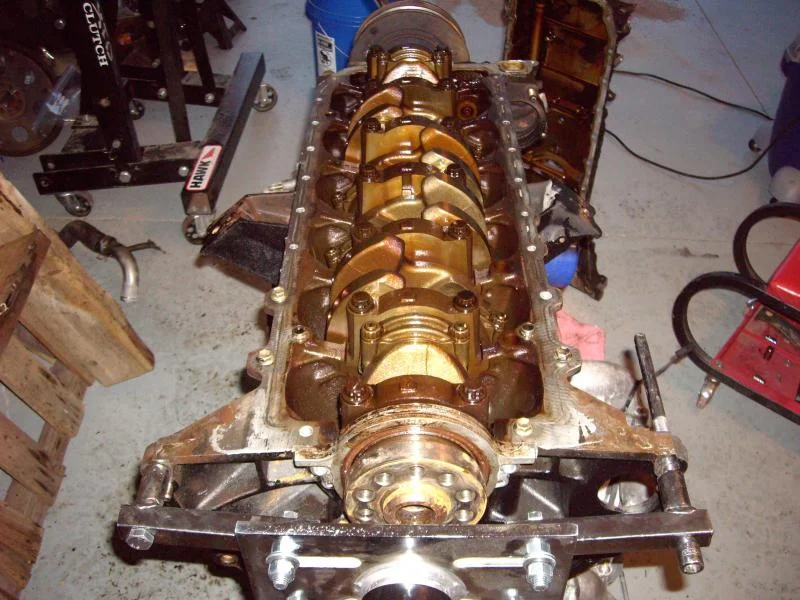

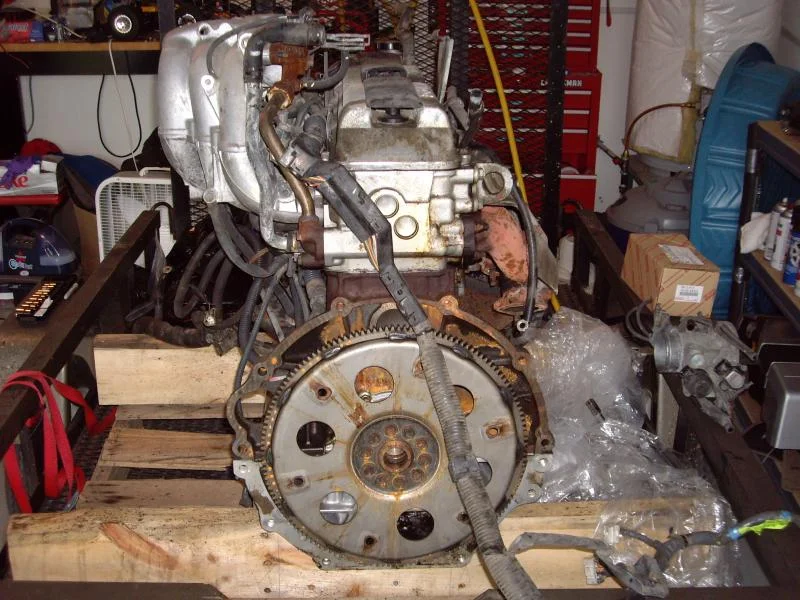

Ok, so it is not as in depth as the Big Gay 2F build was, but I will be doing some things to my donor 1FZ from a 96 that will be going into my 95 to hopefully stop the incessant rod knocking that seems to plague the one in there now. So I took some beginning pics to chart my progress. Note that this is the easy part, getting the one out and this one in won't be so smart.

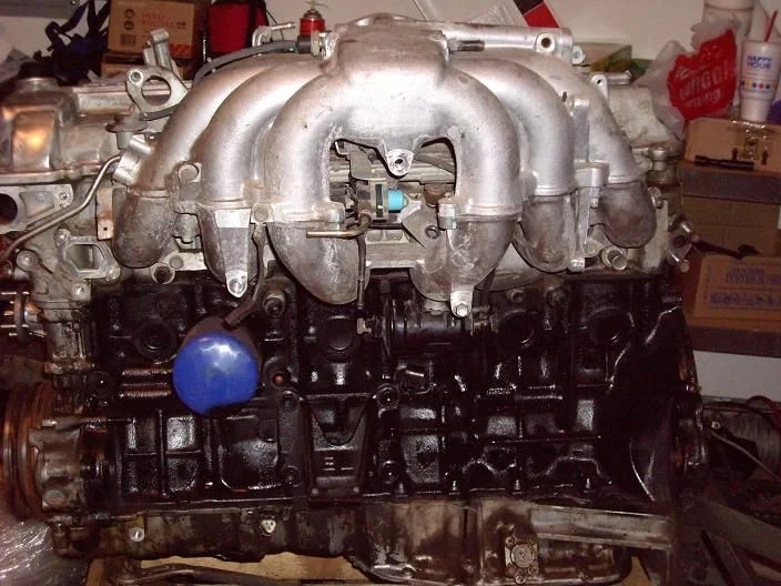

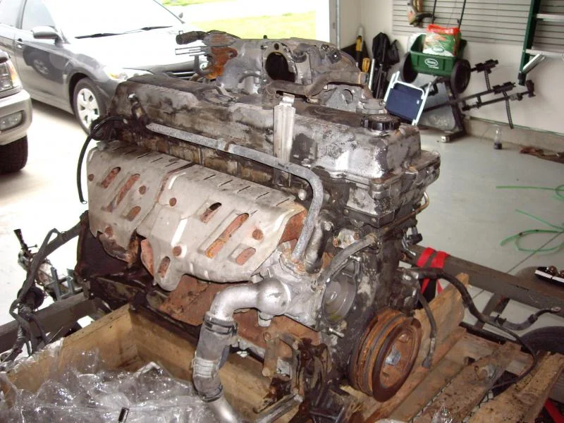

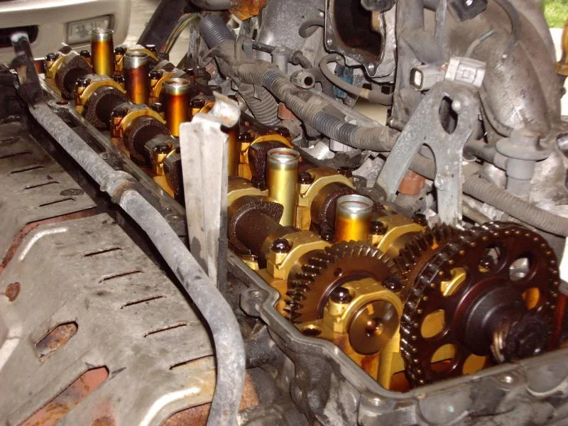

More pics...

Looks like you are replacing the HG? What else are ya doing?

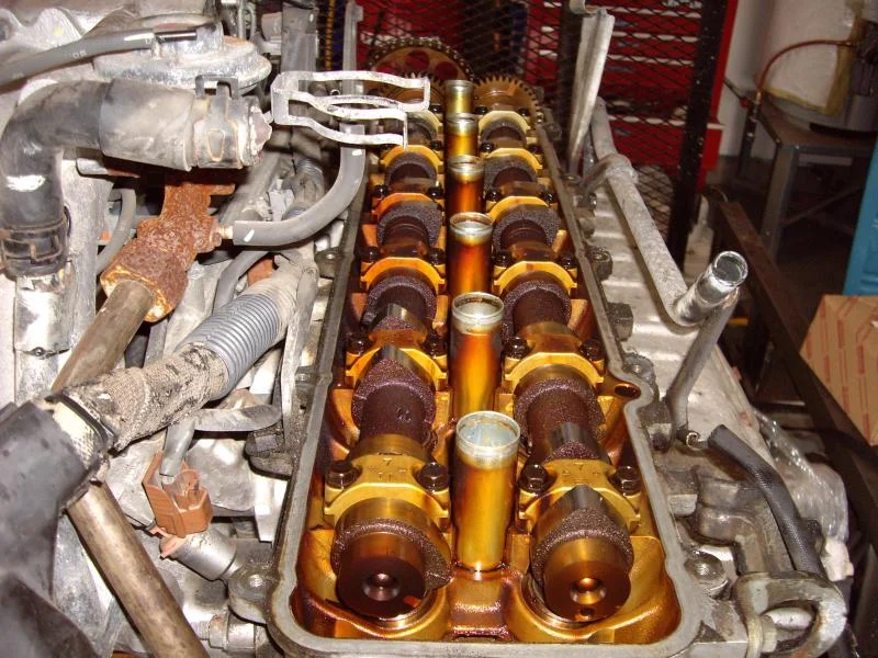

I was checking the valves, doing some PM prior to cleaning it up and replacing some random stuff, water pump etc... It is pretty rusty I guess from being in NH, but I plan to clean it and engine paint it to make it look a little better. I will be doing a bunch of work today, so I will post up more pics today....

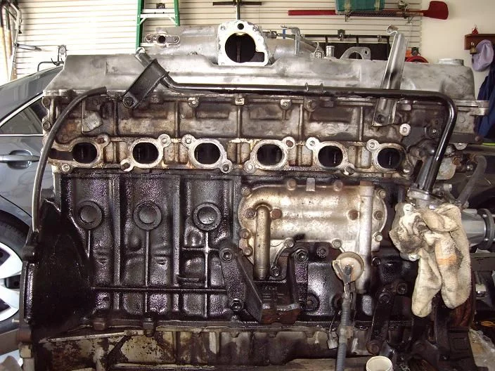

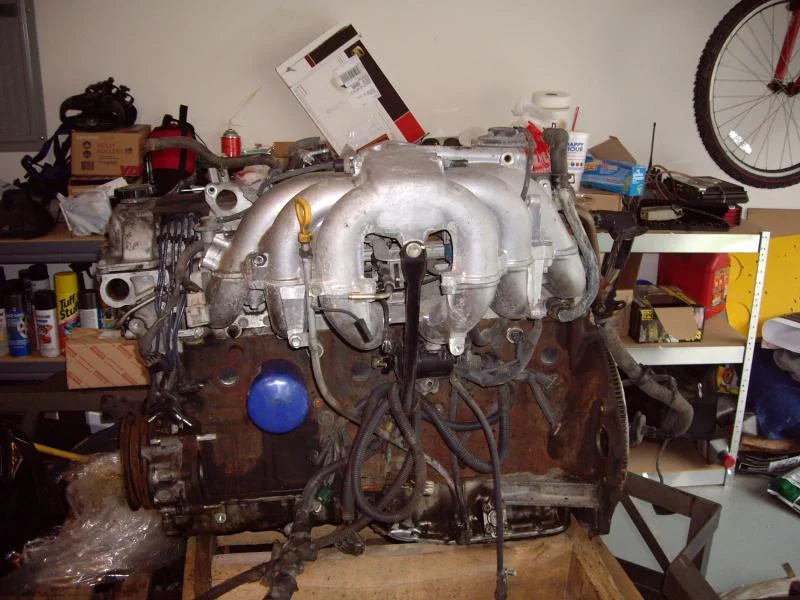

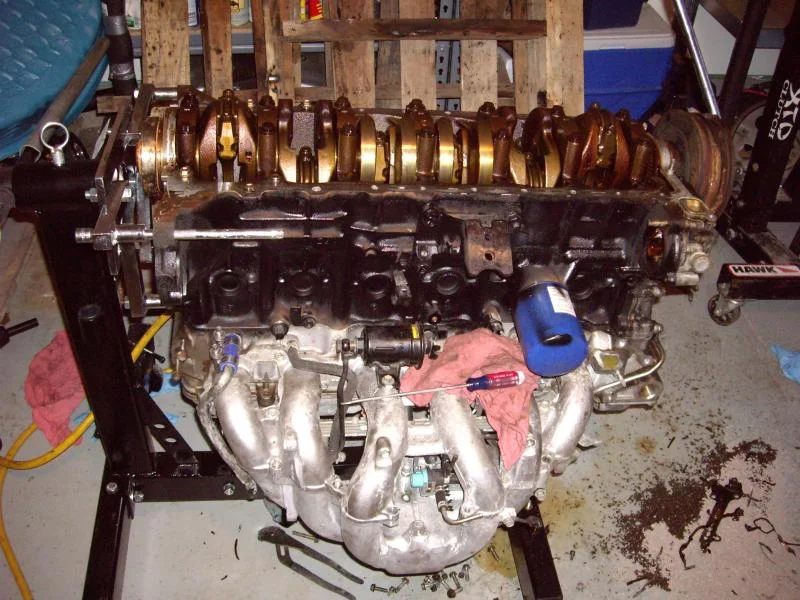

Pulled the water pump and replaced, pulled headers and am replacing the gaskets, cleaning the TB and such. I also degreased/wire wheeled the block and applied a couple coats of engine black enamel. In the second pic you can even see the engine # and designator on the block, pretty cool I thought. It is coming along, I am just waiting to get an engine stand to do some of the rest of the stuff......

Ok, more work on the 1FZ, oil pans removed and caps/bearings/con rods checked. All look good, and cyl walls etc are smooth and clean. I have a problem with the rear main. I can get the retainer loose, but it won't come around where the "flywheel" mounts. If anyone has done this please chime in. Also, big mistake, I cross threaded the oil pan while trying to mount it up to the engine stand, but at least I have another one that I can use from another 1FZ.

Ok, so far, top end looks good, replaced some "non reuseable" items up there, valves were all within spec. water pump replaced, TB cleaned thouroughly PHH replaced with silicone one etc... Today I flipped it as the pics show and since the rod bearings were my achillies heel the last time I thought i'd check them. All within spec and look good for 118k on the motor. So all I really have left to do is do the rear main and put the headers back on (with new gaskets of course). The oil pan will come off of my old truck along with the AC bracket, wiring harness is going to be from the old truck, PS pump, Alternator, Starter Distributor, all the fun stuff but that will be day of swap. Hopefully this won't be the hugest pain in the arse that I have in my mind......

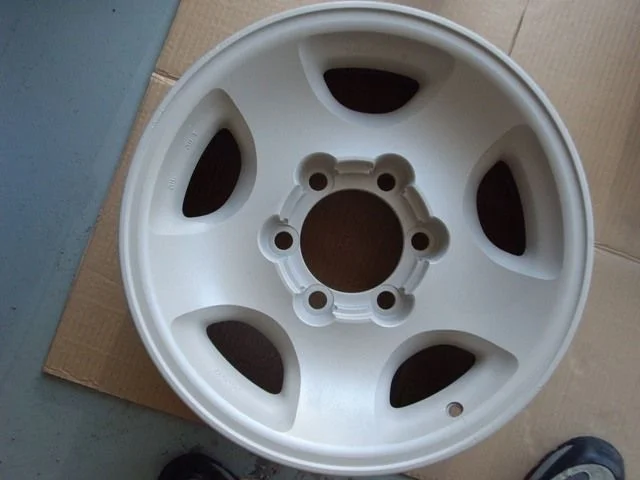

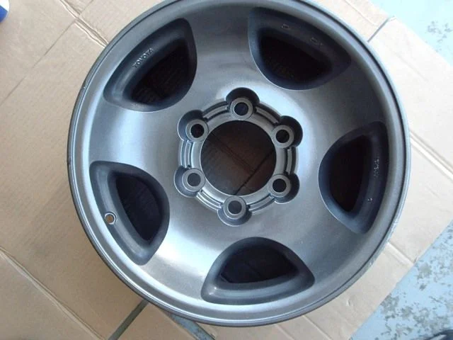

Ok, so off engine topic, but still dealing with the 80, I got the wheels back from the sand blaster today where they stripped and epoxy primered them and they went from pic 1 to pic 2 in ~10 min apiece..... fun

... Also, big mistake, I cross threaded the oil pan while trying to mount it up to the engine stand, but at least I have another one that I can use from another 1FZ.
Be sure that the oil pan and the engine mating surface are very clean, free of deep scratches, etc. It seems that the cast oil pans are less forgiving than the typical stamped oil pan. I rebuilt my 1FZ in 2007, but still have an oil leak at the (upper) oil pan. I used the Toyota RTV and followed the FSM, but it still leaked. That is really painful considering how much work it is to get that engine out.

It is in, it is pretty much all hooked up, just a few doo dads to button up, wires not going where they should etc.... But hopefully we can get it startet soon!!! I have lots of pics, and will post them in the coming days....
