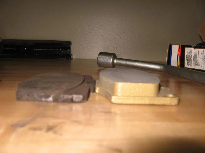

Tackled a new one today, new pads for the 62:
(1) out with the old;
(2) comparing old and new (yikes!);
(3) in with the new!
Felt good doing this myself. Learned alot. I guess I saved about $150 doing it myself.

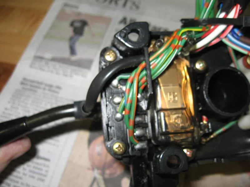

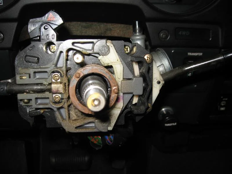

My high beams have not worked for a while and found a solution on the 60's board: take steering column apart, sand contacts on high beam switch. Worked great and saved over $300!
