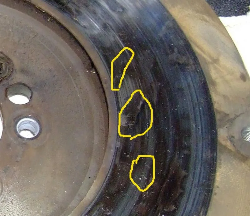

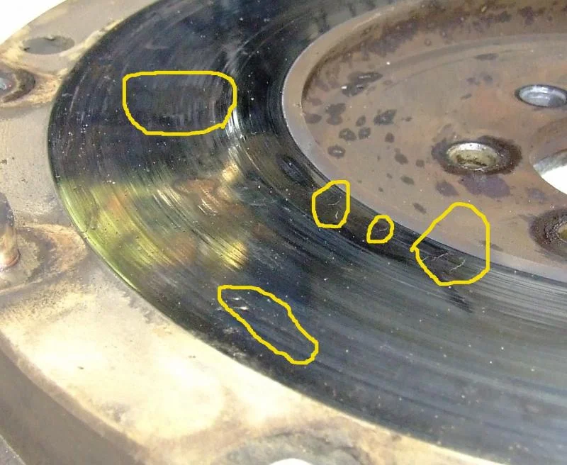

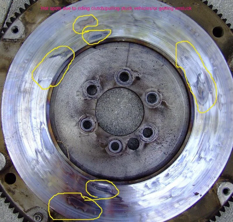

Mystique has a few cracks in her armor. I removed the trans from Brocks Truck today to find some pretty significant cracks in the flywheel, Not very visible by the pics i took, another reason for the wifes new camera purchase, as well as a leaking front inputshaft seal on transmission, leaking front and rear driveshaft yoke seals, a stiff front driveshaft universal joint.
Overall a very NICE CLEAN TRUCK though.
The flywheel will go to the machine shop first thing in the AM to see if machining the wheel will remove the cracks. Hope for the best, anticipate and plan for the worst.
Hopefully Brock will not cringe everytime he sees my caller ID on his phone like BBQ BOY did.LOL

I found both a very good resurfaced and also a brand new from same parts vendor.... FJParts in San Marcos CA...shipping will be $27 to Glenns shop and 26 to my home.
Resurfaced is 180 bucks.....new is 400 bucks. what you think Glenn.....New and hold for next time...or resurfaced if I dont find a good one in area?
Brock is offline   Reply With Quote
Old 06-25-09, 05:31 AM   #57 (permalink)
250+ Club
lextechautomotive's Avatar
Join Date: Dec 2007
Location: Charleston S.C.
TLCA# 34890399
Posts: 416
It all depends on how this wheel turns out this morning and how you plan on abusing/using the 60 as to whether you want a spare laying around.
Under normal driving condition a flywheel can be resurfaced without any issues, but when you take into consideration how we wheel these trucks then it may be a good idea to have an extra. Extra spare parts are always good to have especially when their not available from the manurfacturer any longer.
lextechautomotive is offline   Reply With Quote
