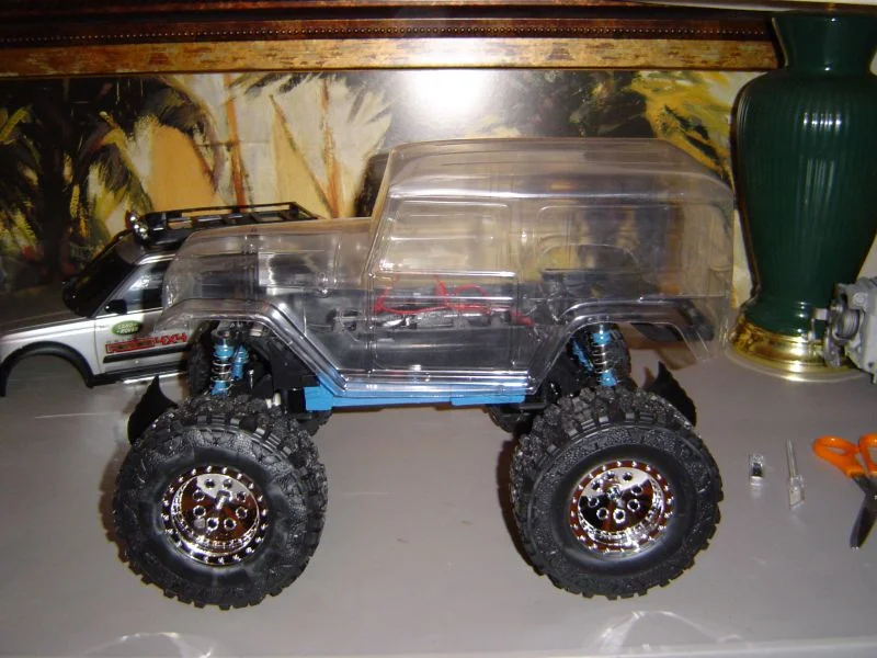

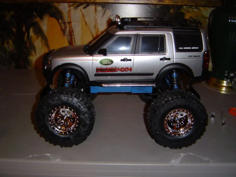

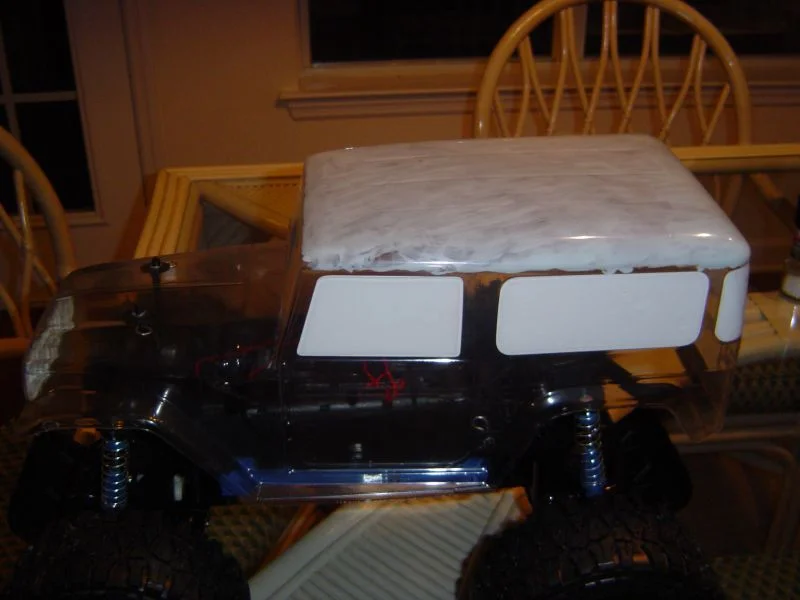

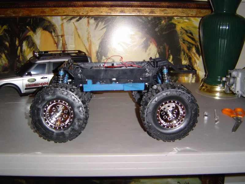

First think was to remove the Poser, I mean Rover body. Just 4 screws and it was off.
Next was to determine How I would attach the new body. I purchased a body mount "post" kit from the hobby shop and it came with 4 posts and all the clips and washers needed to fabricate my own mounts. The front worked out perfect. There was already two holes side by side that held 2 of them perfect. These will come up through the hood. The 2 rear ones will come out on each side just before the rear tires. These will have to be drilled and then epoxied in.
Once I finished fighting with cutting the body out, it was time for mock up to check clearance. With the very limited susp. flex of this "toy" there will be no need for addidtional trimming. (Note to self, get proper cutting tools to trim the next body.)

Very cool. Painting tip: burnish the edges of the BW masks with a q-tip end or
some other small round thing or else the paint will bleed into the masked off area.
A black sharpie works wonders for those window trims and details you want black.
Those little curved tip lexan scissors are very handy.
Be sure to use paint for lexan bodies so it will not flake off when the Cruiser takes a tumble
on the stairs.
I love the beadlocks and crawler tires!

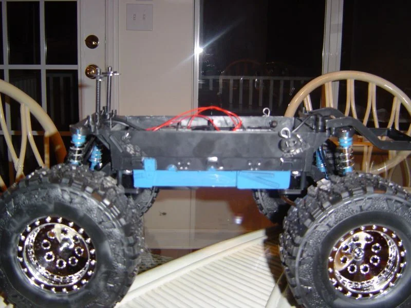

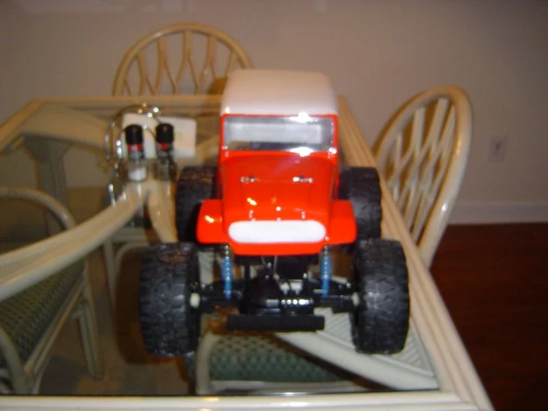

I got the Losi body mount kit installed. 2 posts on ther hood, one on each side. They worked out nicely.

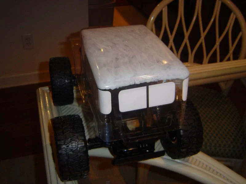

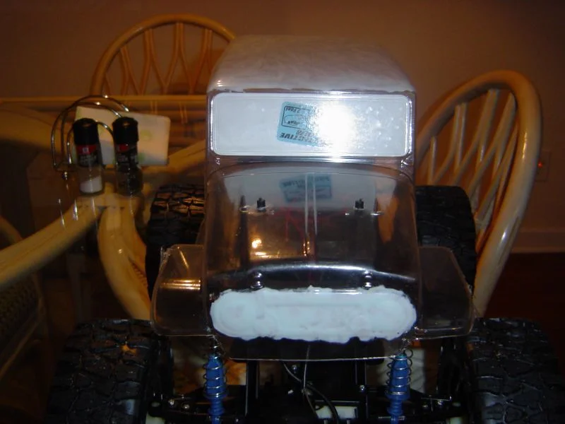

Next I got the window masks placed and drilled the holes for the body mounts. Next I applied the first coat of liquid mask to the top and bezel. The plan is to apply a second coat and let it dry 24 hours. Then I will trim out around the edges before paint.

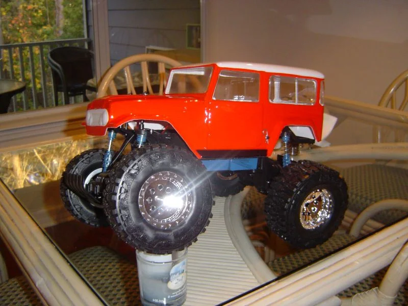

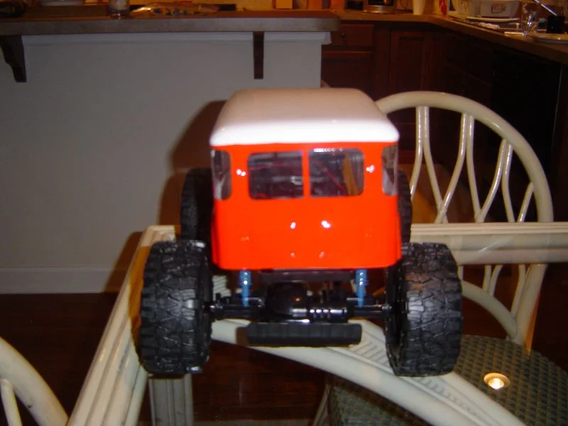

She is all painted up now. Painted the rockers black with a sharpie then sprayed the red on. Used 2 coats drying with a hairdryer in between. Then I removed the liquid mask on the top and bezel and layed the white down. The mask worked really nicely. Sprayed 2 coats of white and dried then came the flourescent undercoat. Not sure if that made a big difference, but the red does really pop out. I removed the window maskes and protective overspray film on the body and was p;eased with my first body. All thatis left now is to put a few stickers on.

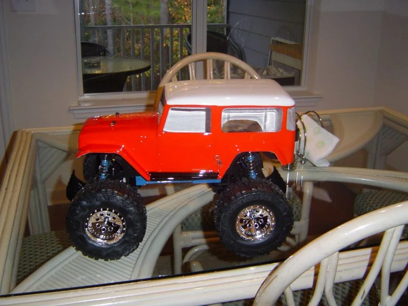

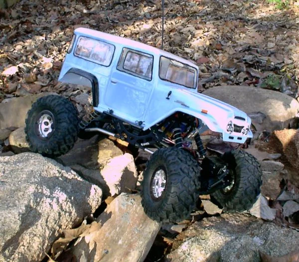

And here is the poser shot of it climbing the "Glades".
Jeremy

Thumbs up Very cool
Nice! The red really does "pop". As for stickers, Towerhobbies.com sells
the stickers for the CR01 for about $9. They are neat details to make it more scale.
Turn lights, the upper grill piece, the Toyota for the grill, the Land Cruiser name along
the front fender, the 4WD sticker on the rear, backup light and windshield wipers. http://www3.towerhobbies.com/cgi-bin...?&I=LXUSJ6&P=7
Looking good, nice job and I'm sure the tot will cherish this as time goes on.
