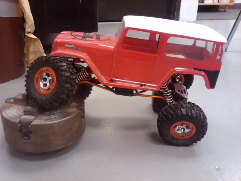

I've got the stock body for real rock climbing. The cruiser body is just for pimpin'  It does help a lot with rearward endos. It just sits on the rear doors until I give it a dab of reverse.

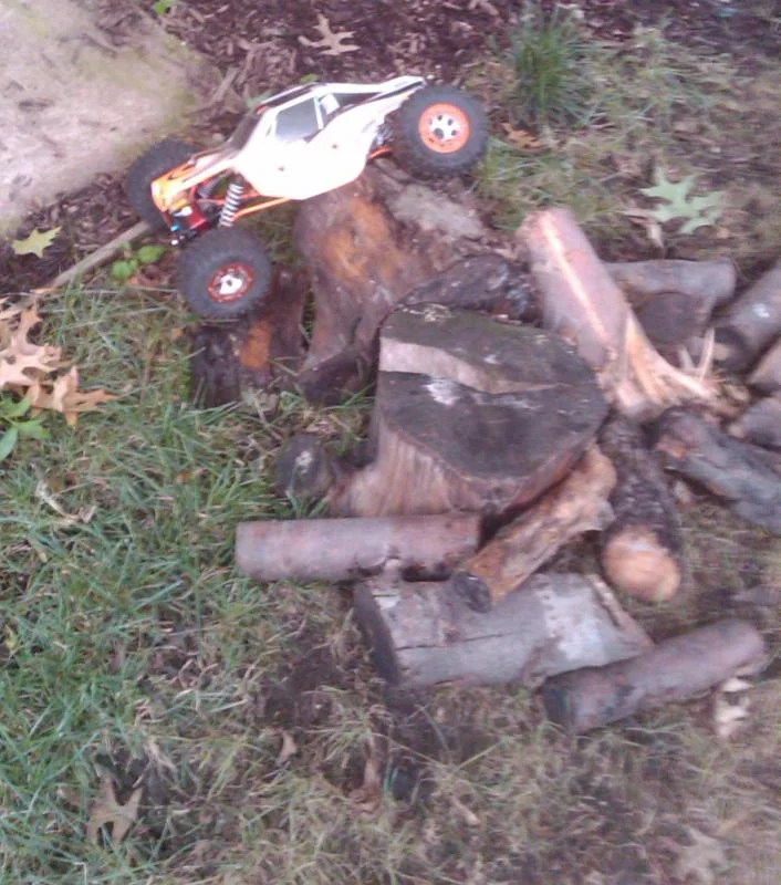

This crap is way too much fun.
Been staring at the Outcroppers for three days waiting for the beadlocks. They were sitting at home when I got here along with the new tuber body.
I'll have to break them down to weight 'em, drill 'em and modify the foams, but I couldn't wait and mounted them up.
The FJ40 body still fits on over the tuber, but it'll need trimmin and I'll have to do something about the lack of body posts.

Ran the outcroppers this morning and they sucked.
weighted them and put in the star cut memory foams from the Hammers and they now rock. I just did the fronts and it's a world of difference.
I can't get them up my patio step yet. It's a vertical climb just shy of the wheel base. I have to freewheel the rear axle with the dig or it flips it. Rather than just spin like the Hammers did the Outcroppers flex and dig and try really hard. I bet I could make it with some effort.
