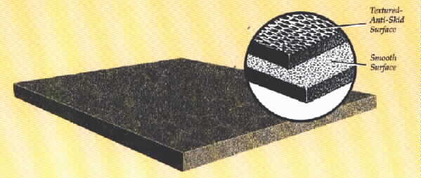

Find a horse or ranch supply store. Buy a horse mat. It's a mat that's very strong and about 1/2 inch thick rubber kinda stuff. They are usually about 4x8 feet and should be around 25-35 dollars. You can cut it with a regular razor knife, but it takes a few passes. Anyway I think it should work for what you are needing. It's good and thick, so it should hold it's form, and one mat should be more than enough for two flaps.
Here's a link for what I'm talking about http://www.ncnwest.com/rbr/sizes.htm lots of places think they should get like $2-300 for them? don't know why, I'd pay no more than $40, but you should be able to find them for less.
^ this stuff:
