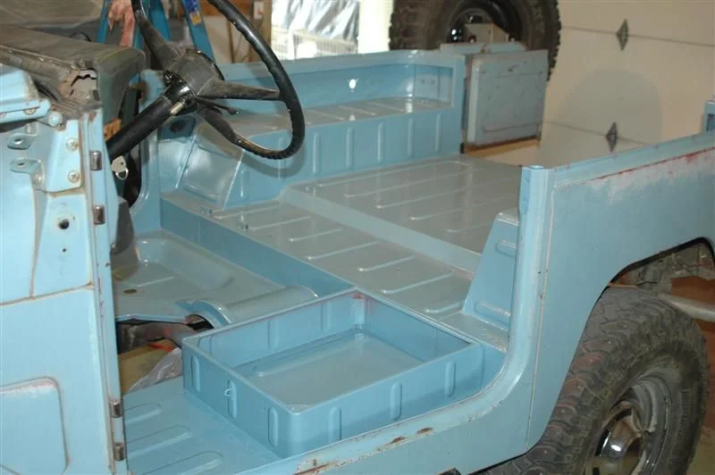

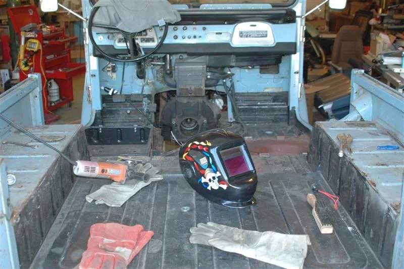

Hey guys, figured I would start a thread. I am hoping on using some color matched ace to re-spray the interior of my 69 fj40. The PO of my 40 decided it was a good idea to brush black rustloeum all over the interior...Really this is a "long term temproary fix". Someday I will be taking the 40 down to the frame and having the body soda blasted. In the mean time I can not deal with this uglyness. The PO also decided it would be a cool thing to put carpet all over the floor with spray glue. Lemme tell ya I just love freaking PO's. He also screwed aluminum 90 trim all over to hold the seams of his custom carpet kit down. So I have welded up about 50 holes all over the rear floor and fenderwells. Other than this crap from the PO my 69 is totally unmolested, original paint, and hardly a lick of rust.
I am about half-way through prepping the interior.
Still experimenting with how much to thin the paint and how to setup my el cheapo HF special HVLP.
I have a lot of questions but I will just start with a few that I have been pondering on...
1. I am not planning on removing all the old paint. There are some areas that I would like to neutralize the rust. Phosphoric acid bath? Will this hurt the paint on the exterior when I rinse if off? Where to get it? I also have some TSP...not sure what to use.
2. Primer...Still stumped here. I am experimenting still but I think I want to be able to use highbuild 2k to help level out the imperfections. Can I spray this right on the old paint/bare metal or do I need to spray an epoxy primer first?? EDIT: Pretty sure I am going to spray a couple coats of Epoxy down 1st. Then maybe some highbuild....not sure there yet. Will see what it looks like with the epoxy down.
3.Paint takes a LONG time to cure...what kind of hardner can I add to it? How much are you guys thinning to spray thru HVLP? With what? I have just used odorless mineral spirits so far about 4 parts paint to 1 part Spirits. I think I need to go thinner...I sprayed my toolbox lid yesterday with the 4:1 thinned and it seems to be drying MUCH faster than the stuff I straight brushed on some parts when I first got it...pretty orange peely tho...
before pic...only welded the holes

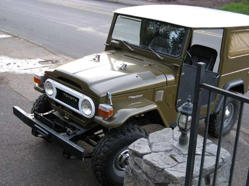

ACE paint takes along time to dry. Thinning it like your doing is a big help. But you have to be patient. What I did after a week of drying was to shoot clear over it. That way it has a nice rock hard finish. I used Valspar auto / industrial grade LIC-30 clearcoat. It's cheap and does the trick.
You may also want to look into PPG ALK-200 paint. It is wonderfull, and $57.00 a gallon. Its an industrial paint so it acts and dries like auto paint should.
I did my whole rig in ACE / Clear, but if I had to do it over again, I would go the PPG ALK-200 route.

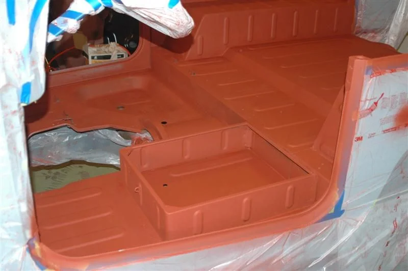

Well there is no turning back now!!! woot! Primer round 1!

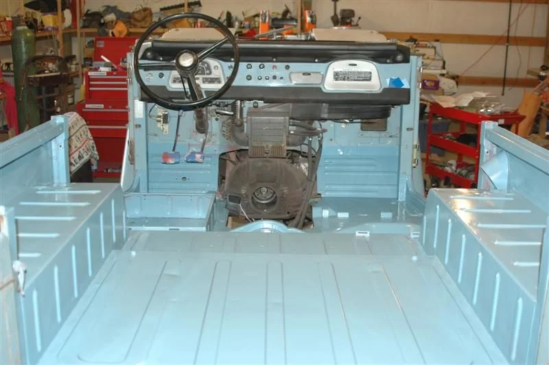

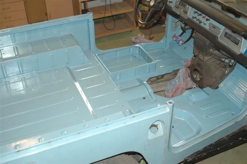

WOOOOT! Super stoked. Turned out real good for a long term temporary fix!!!
2 coats of primer 1 good coat of paint. Thinned 4 to 1 with odorless mineral spirits with a bit of valspar enamel hardener added for kicks.
Sprayed thru 14$ HF HVLP. Gun lasted thru everything but started leaking right at the end. It saved me from cleaning it out again LOL.

Thanks guys! I am pretty stoked. First time using an hvlp and it was NOT EASY getting it sprayed out.
Lots of nooks and crannies and akward angles to deal with!!!
O ya...its stil a lil soft...I can dig a fingernail in if I really mash it.
We have PERFECT paint drying weather here...10% humidity and 80+ degrees.
I let it bake in the sun today...same tomorrow. Then its time to start putting it back together!! Woot!

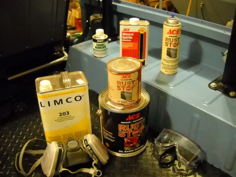

1.sand a lot more than you think you need to
2.keep sanding
3.wear a real respirator, goggles, suit, gloves, hood.
4.practice first
What I would maybe do different...
I sorta wish I would of shot some highbuild/blocked it. You can see where the old paint is feathered out thru my paint job...o well still looks tons better! And I was way way over sanding! There is a LOT of akward crap to sand in the interior of a 40!!! My main goal was to feather everything out and get all loose paint/spray glue/rustyness off. And I think I did good there...the primer stuck real good.
The hardener I used is gnarly...same nastys thats in real auto paint. And I dont think it made much of a difference.
I just about have my 40 back together. Once I do I will layout all the tools, and materials I used and snap a pic to post.
Paint is cured enough to start bolting stuff up. Gotta be a lil carefull yet as you can still scrape it if you try hard enough.

Here ya go. Paint code letters on left side from the top-bottom B,E,L
These are all the main ingredients. The Limco 203 is a pre-paint cleaner/de-greaser that I got at the auto paint shop. Figured it would be handy to have a gallon of it. I put some in a spray bottle and wipe down with a clean rag, then tack cloth. Stuff works awesome and seems to help paint/primer stick real good.
Anything rusty was sprayed with Ospho (forgot to put that in the pic get it at Ace in the paint solvent area) then wiped off with a clean rag then let dry 24hr before paint.
Rattlecan primer I just used in areas I missed or sanded through. I used red primer as thats what was oem on my rig and its showing through all over the exterior where its weathered/scratched...this should match well with some use!
The Valspar Hardener I ordered from a Valspar dealer. Check Valspar.com ? for a dealer near you. Its got nasty stuff in it so use a respirator, goggles, suit etc.
I sprayed the primer and paint both through a 14$ HF Sprayer and it worked great till the very end then it started leaking somewhere...o well I was done anyways!
The paint code was scanned from my kickvent that I buffed out a lil bit...original 40 year old paint. Match was ok...not perfect at all but close enough for my project.

You will be stoked with how it sprays...I thinned 4 parts paint to 1 part mineral spirits (or so). Think you could go thinner.
Mess with the gun and practice a bit on something 1st.
Only downside is paint is slow to cure.

Overspray was very minimal. I sprayed it in my 24x36 shop. Only thing I noticed is it is attracted to plastic. Very dry here lots of static buildup. I put plastic on my sandblast cabinet window (plexi) as the first coat I sprayed got on it. Didnt bother covering anything else. I had a window open on one side and a fan blowing out the other side window. My window screen is blue now.
DO WEAR A RESPIRATOR!!! AND GOGGLES!!!
