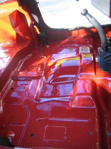

I just finished using rust cap hammerite coating the entire floor of my jeep, (practice and expermenting before using it on the FJ40)
I liked the result, shinny, slick, hard, but not real glassy smooth.
Some of you might want to consider this insead of the black rubber liner crap that is hard to clean. If you are not picky about small brush stokes. But super easy to keep clean. 3 pictures of the result and product, of which I have no affilation with. Thanks.
This is not what you want to use in a restoration, but would be great on a Daily driver or trail.
Hard to brush on because it dries fast. Use only about 2 oz at a
time, because of drying issues, I used a paper expresso cup and a 1 1/2 bush, keep the cup wall wet and your brush at all times.
Working with this stuff is tricky, might want to do a test and practice piece first until you learn to work with it. recoat 2 coat after 20 minutes, by the time you use the 2 oz in the cup the first part of your work will be dry so the 2 coat is ready to go on.
get your first strokes well covered, because you can't back stroke over your work after about 15 seconds. Takes about a week to harden enough to install seats and such. I waited about
10 days. 2 weeks and it is hard as can be. Put your rubber
floor mats down and call it done. It is real shinny and slick so water and dirt just roll off.
I used 2 quarts to cover this jeep floor, and it is only about 18 dollars a quart.
Xylene for clean up
I used the same stuff on my grill, headlight trim and side vents and really like how it turns out. I used the grey color. Looks Good!

surface prep
Here is a picture of the surface prep the black on the front floorboards is por 15. Had to replace some metal, so I coated it with por 15 until I could give the entire interior a coat of the rust cap hammerite,second picture is finsihed productIMG_2365.webp
update to the orginal thread
Ok
It has been one year and the hammerite is still holding up well
No chips or peeling of the product. And so sign of rust popping
though. I am still happy with the product.
