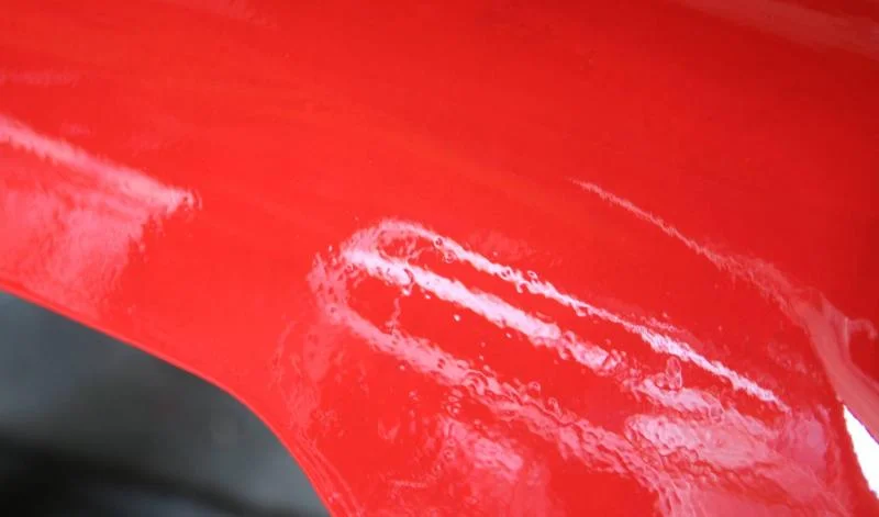

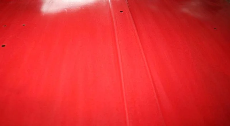

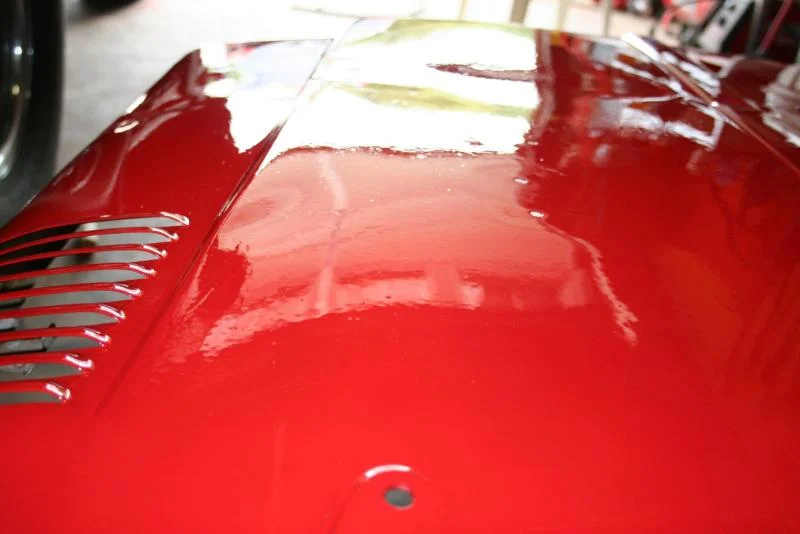

Orange Peel - What not to do; now what?

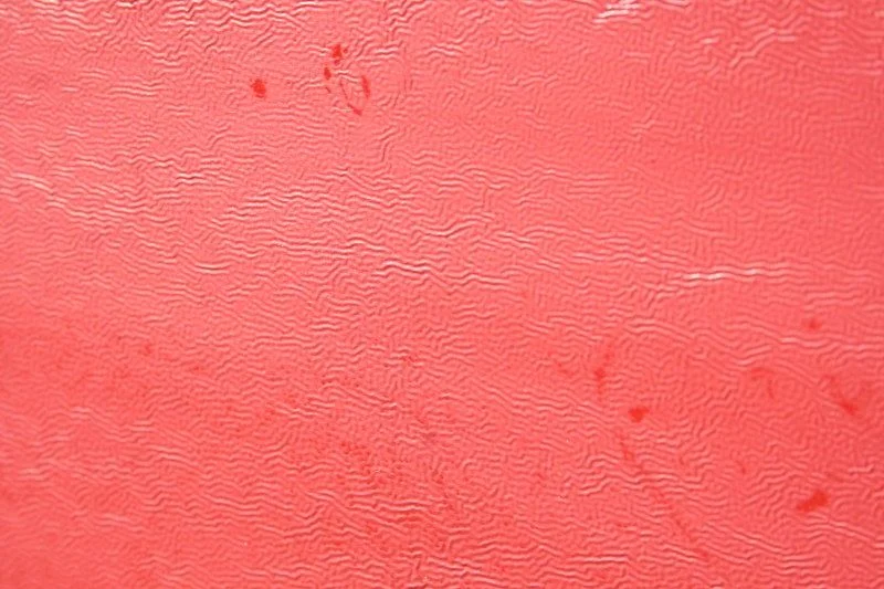

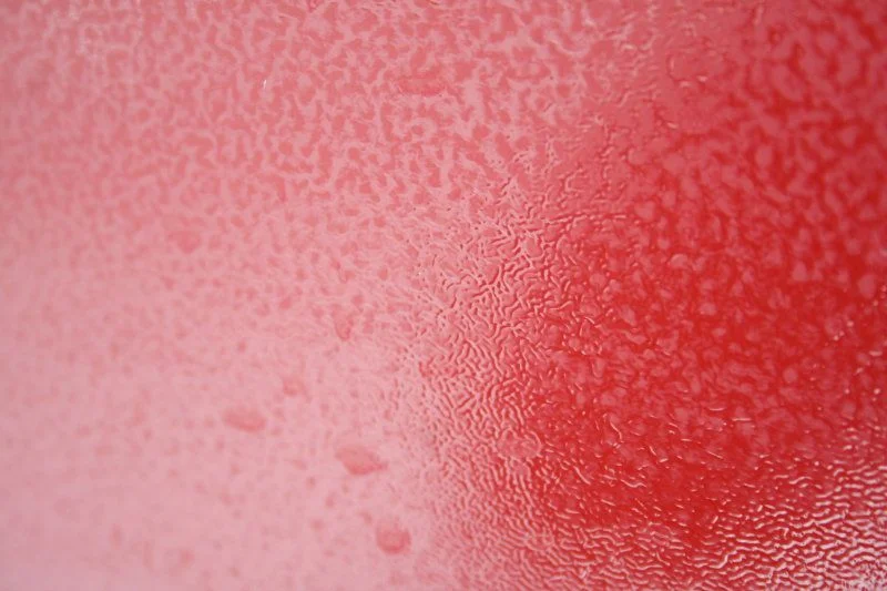

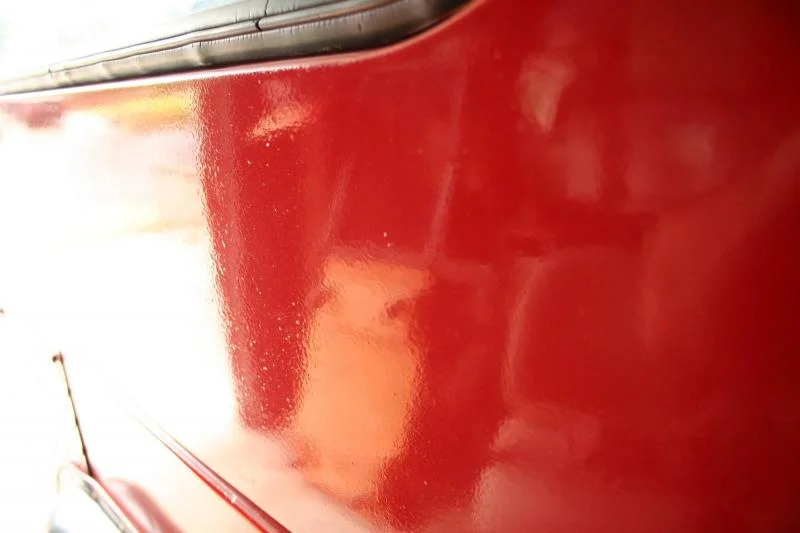

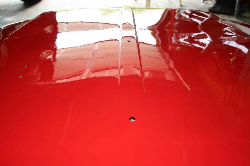

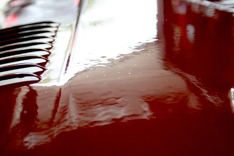

I just got finished painting the Ht on my 40. Everything looked good while I was painting it, then this morning I had a whole lot of orange peel. How does this happen overnight?
I used Rustoleum Regal Red over primer, which was wet-sanded and smooth upon application.
As the title goes, now what? I have wet-sanded using 600-grit to remove many of the spots, but is there by chance another way?
Thanks in advance.

Let me add that the paint does seem to still be soft - now 20 hours later. The paint seems to be reacting to changes in temperature: whereas one area did not have orange peel, now it does since the ambient temperature is rising. Does tempurature have anything/everything to do with it?

That is beyond orane peel, it is almost a wrinkling or folding. Did you use a catalyzed paint? Are you using acrylic enamel? Is everything the same brand, from the same supplier? Temp will normally not cause the problem you have, although the reducer should be keyed to the temp when spraying. No way it should be soft if you're using a hardener (catalyst). Once it's on there, you're toasted. Do not wet sand until the paint is hard. How great is the temp swing?

I apologize for not being clear in the beginning: I am using spray cans.
I figured it was beyond orange peel, but did not know what else to call it.
I used the same color, brand, etc. all the way through the job.
The temperature was 78*F when painting and is now 98*F in the shade, where it sits currently.

I've had that happen on a few small projects. Turns out I was laying on too thick of a coat and piling more on.
From Sherwin Automotive-
Paint film having an uneven texture that resembles the skin of an orange.
CAUSE
  1. Under reduction and/or air pressure too low.
  2. Thinner/reducer evaporates too fast for spray conditions.
  3. Excessive film thickness or piling on of heavy wet coats.
  4. Improper spray gun set-up.
  5. Improper painting technique.
REPAIR
  1. Compound or polish to reduce surface texture.
  2. Or, sand smooth with 1200 or finer grit sandpaper, compound and polish to restore gloss.
  3. Or, sand smooth and refinish.
PREVENTION
  1. Use proper reduction ratio and spray at recommended air pressure.
  2. Select recommended thinner/reducer based on temperature, humidity, air movement, and size of repair.
  3. Avoid heavy coats and excessive film thickness.
  4. Use recommended spray gun, fluid tip and air cap for the material being sprayed. Always adjust the gun for best atomization and balanced spray pattern before paint application.
  5. During paint application, hold the gun perpendicular and parallel to the surface. Adjust speed of pass, pattern overlap, and distance from the panel to achieve the desired appearance

I did apply some thick coats - apparently too thick. The paint was going on so well, and without running that I thought it was OK to lay it on a bit thick. I painted the rest of the truck about a year ago, but had to use thinner coats since I was using a different paint brand.
I am not going to sand down and apply new coats since I used the last of the paint already.
I guess I have a lot of sanding to do to get it looking at least halfway decent.

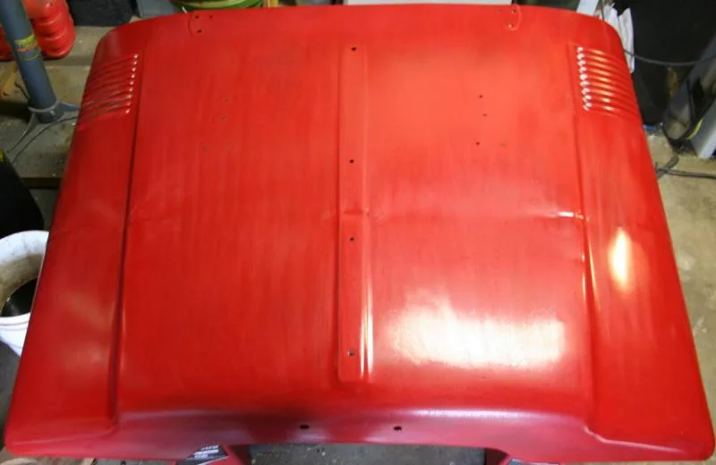

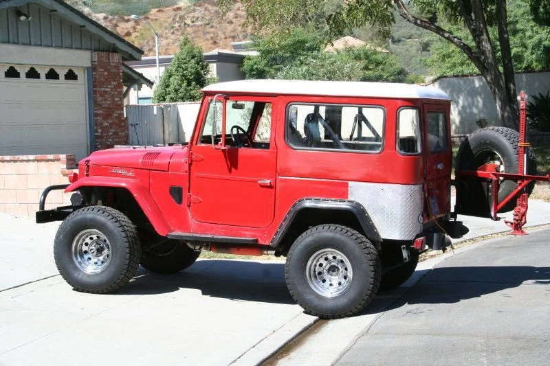

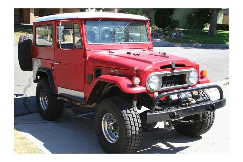

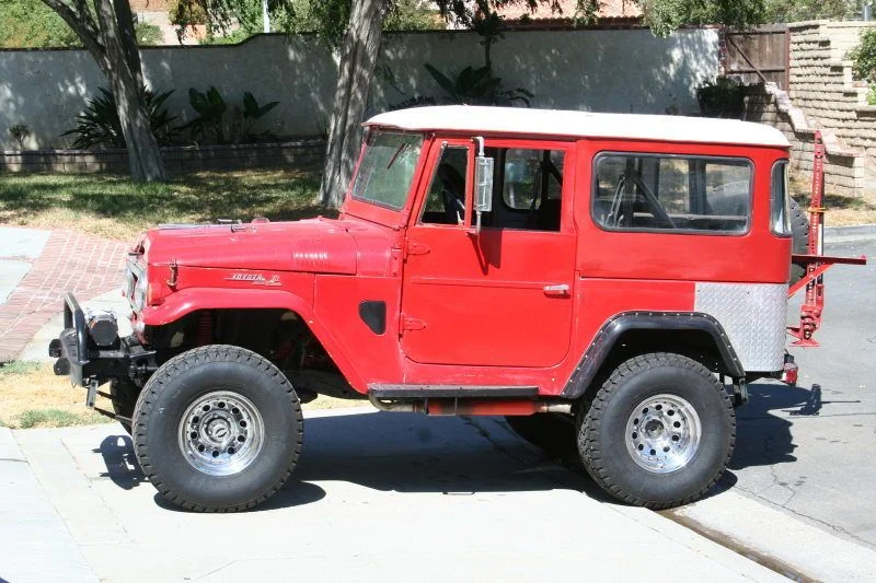

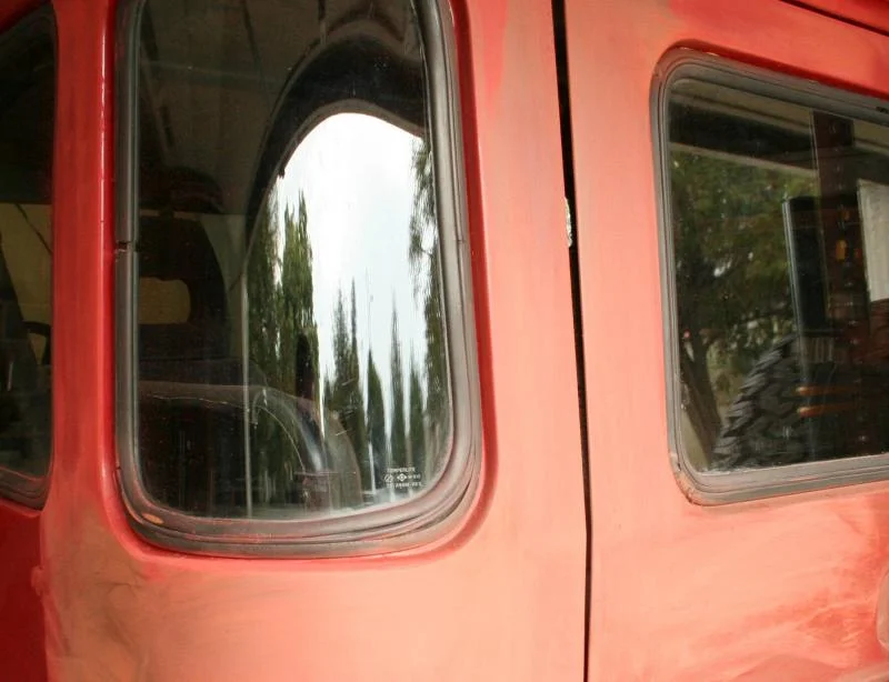

Might as well show the rest of it...
Here are the full pics of the rest of the rig the day following the job.

Updated Pics
As promised, here are some updated pics of the progress on the hood and a couple before and after shots of the top.
Enjoy.
The first pic is just after sanding the first two coats with wet 600 grit.. It appears to be rough, but it is actually quite smooth and level; perfect for the next coat.
The second is a view of the center section looking toward the front.
The third is the full view. You may notice that there are dents in the hood (discussed in another thread): I decided not to try to straighten it out since it is much better than what I have now, and I am not tooled up to do the job.

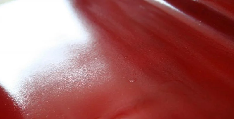

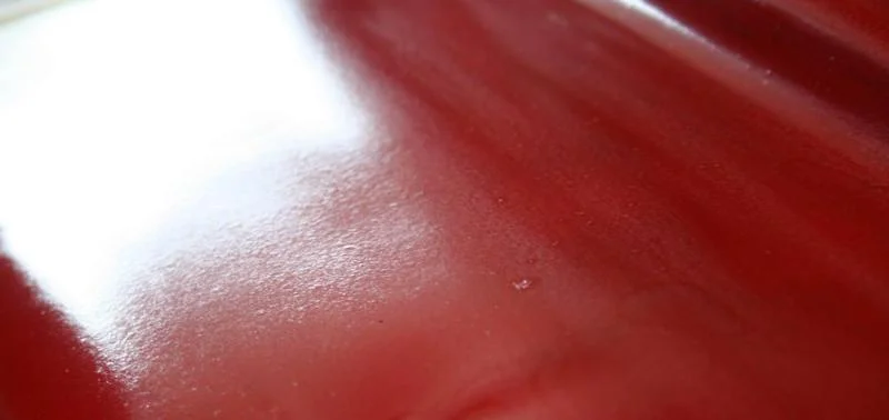

The top picture gives you a good idea of the texture prior to applying a fresh coat.
The second is just after a fresh coat. Shiny!
The third shows just how rough a fresh coat will appear after rolling it on. All of the roughness settles rather quickly, which is due in part to the thickness of the paint. I used an approximate mixture of 1:1 mineral spirits / paint, which seemed like too much thinner, but ended up just right. If I had not thinned it as such, the bubbles would remain: too much thinner and the vertical sections would run. It is a bit tricky to get it just right, but ultimately I just started with 1:1 and added paint to thicken it.

More...

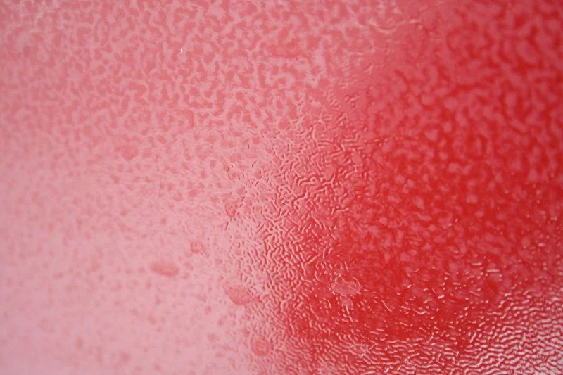

The top pic is a better example of the texture after a fresh coat, all of which levels out nicely.
The bottom pic is also after a fresh coat - it too leveled out pretty well after about a couple minutes.

Back on to the top...
The top required a lot of sanding to get all of the wrinkled paint down. In fact, it has taken until this time, or from the first post in this thread, to be almost completely dry!
I brought the back corner (top pic) down to primer, then applied another coat of primer to even it out.
The second pic shows what the end result of sanding achieved along with a two-coat application. I have not wet-sanded or polished this portion yet. Much better than it was! I will be applying a few more coats, wet-sanding with 600 between each coat.
