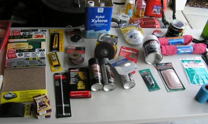

Okay, so here is what I got:
-Paint pan
-3 paint pan liners
-drop cloth
-40, 60, 80, 100 grit sand paper
-100 grit sponge thing
-sanding discs
-xacto knife w/blades
-rust brush wheel for drill
-rustoleum primer
-xylene
-masks
-metal bondo
-rags
-3m masking tape
-electrical tape
-4" rollers

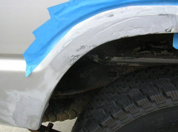

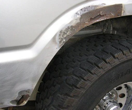

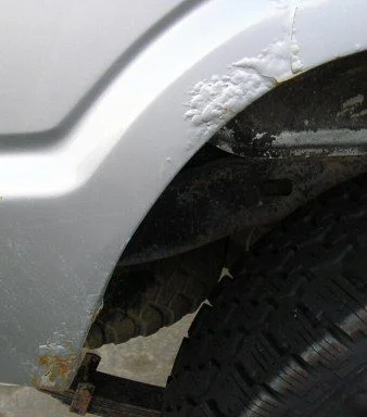

-prep body where paint is bubbled/rusted (see pic)
-fill holes/sand/prep where chrome trim was

The bubbled paint that I will sand down, bondo if needed, and prime...

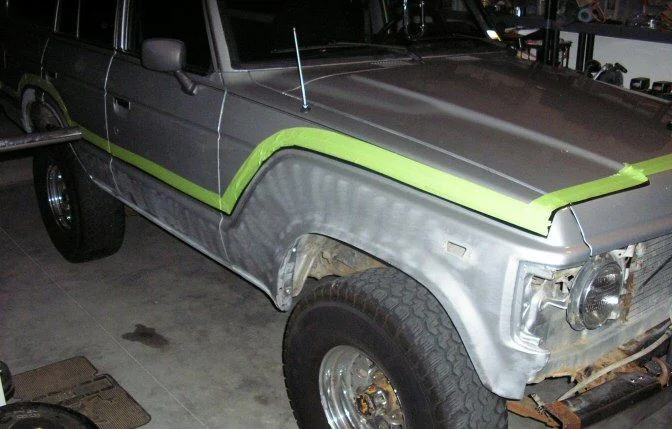

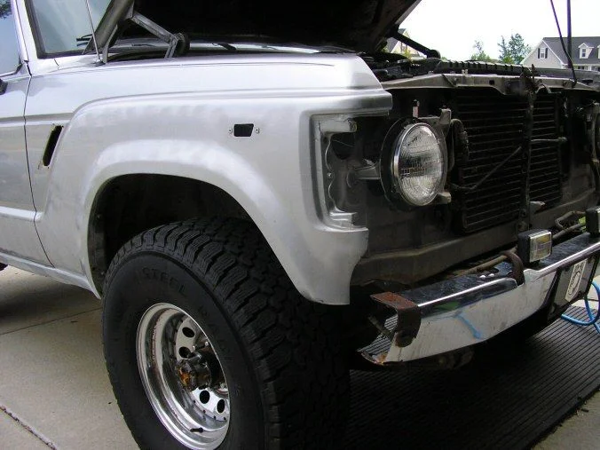

Started raining so I figured it's time for an update...

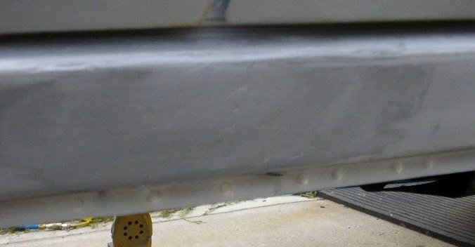

Everything is pulled off. I kept the front bumper on and took off the valence thing under the grille cuz the front bumper wasn't going to come off any time soon, so I will just durabak that valence thing off, then bolt it back on.
Everything is sanded down and all holes have been plugged with metal bondo. All I need to do now is tape, final sand, xylene, then paint.
I will probably black out the "Toyota" on the grille while I have it off.
Here are some pix, more to come...

Ready to tape...

PREP DONE:
First layer of tape is electrical cuz it follows curves much easier. The next 2 layers are green 3M masking tape.
All the areas are sanded with 80. I will xylene tomorrow when I am ready to paint.

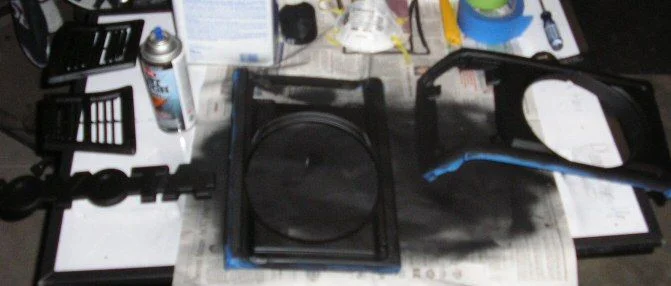

Since everything was off, I decided to sand, clean, and black out a lot of those trim things...

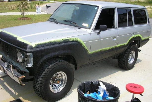

APPLICATION
(I added a 4th layer of masking tape just to give me room to play)
First I did a xylene cleaning twice to the areas I was getting ready to paint.
Okay, I layed out my painting mat so I didn't ruin my driveway, got my drill with paint paddle, durabak can, paint pan with disposable liner, roller, and durabak roller.
For every section of the vehicle, I re-mixed the paint to keep the particles suspended. So, instead of pouring the paint into the pan, I just dipped the roller in the can, then ran it up and down the pan to distribute the paint.
I then set my stopwatch cuz it is hot and humid as hell here in NC so I figured my cure time was going to be much shorter.
For the FIRST coat I painted side to side and went thin, just enough to see a little color through the durabak. Again, at each new section of the car, I would slide all my crap down, re-mix the paint, then paint.
The first coat took my about 27 minutes. I put the roller in some xylene, closed the can, got some water and let it cure for about another 30 minutes.

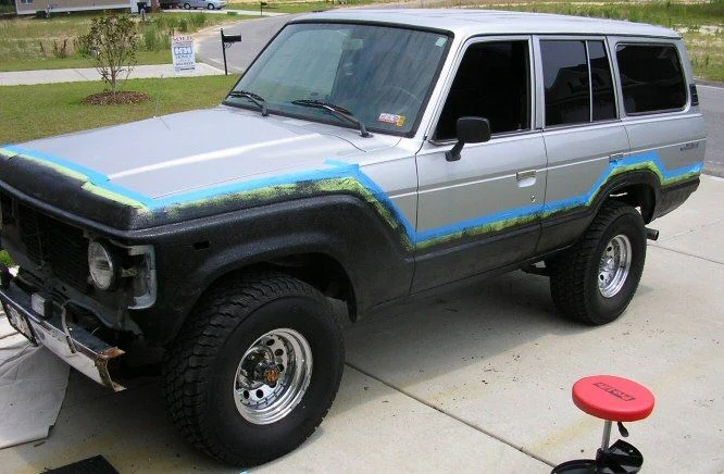

After the FIRST coat:

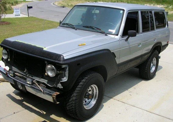

SECOND coat: nothing different except I went up and down with my strokes. Same as first coat other than that: mix, paint, move, mix, paint move.
This coat again took me about 27 minutes. After this coat my durabak roller finally fell apart, so I got my second one ready for the third coat.
After this SECOND coat, I stripped that 4th layer of blue tape fwiw.
I sill waited it out so this coat had a total of about an hour to cure.
SECOND coat, 4th layer of tape removed:

THIRD coat
I did decide to do a third coat since there was still paint showing through on lots of spots.
The directions stated to remove the tape after the second coat. I assumed that was with the understanding that a person was only doing 2 coats, so at this point I just repeated my sytem for a third and final coat with the exception of using a brand new duraback roller thing, switching back to side to side strokes, and taking a regular brush and "stippling" those hard to reach places.
Same as normal, mix, paint, move....
This coat again took me about 25 minutes. So total time is nearly 2 and 1/2 hours of curing time. I immediately went to remove the rest of the tape EXCEPT the last layer of electrical tape.
I was getting nervous that the durabak may have cured too long and that the tape was going to pull it off...it didn't.
Final coat, all tape but electrical tape pulled:

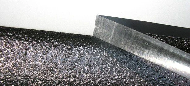

REMOVAL of electrical tape:
By the time I got all but the last layer of tape off, the 3 coats had been curing for about 3 hours in hot, humid NC. I thought for sure the electrical tape would pull all my work off...it didn't.
And the "ledge" people have mentioned is so very small even after 3 coats. Don't worry about it.
Just went slow and smooth.

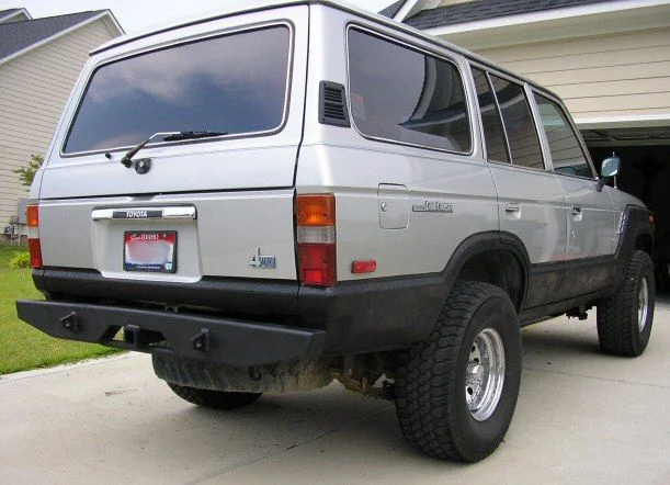

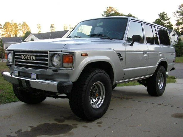

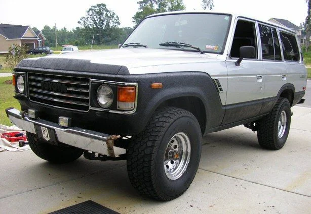

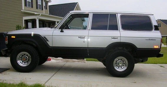

Final product all buttoned up with newly blacked out stuff:
(Before pic is 1st)

And last one...
