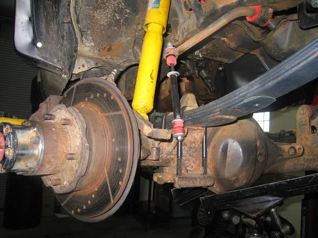

What would you guys use to paint these axles? There really isn't much rust but I'm rebuilding both front and rear axles this summer and installing new TRD elockers so there will be a bit of welding on the axles. I want to do this once and never again. Therefore I'm considering products like POR15 with Chassis Black topcoat or Rust Bullet with their top coat, etc.
I also want to paint the dust shields, J arms, etc. while everything is apart.
Maybe just a good primer and top coat instead of all the expensive rust-killing products?
Here's a photo. Needs a good steam cleaning as it's got years of red mud everywhere.

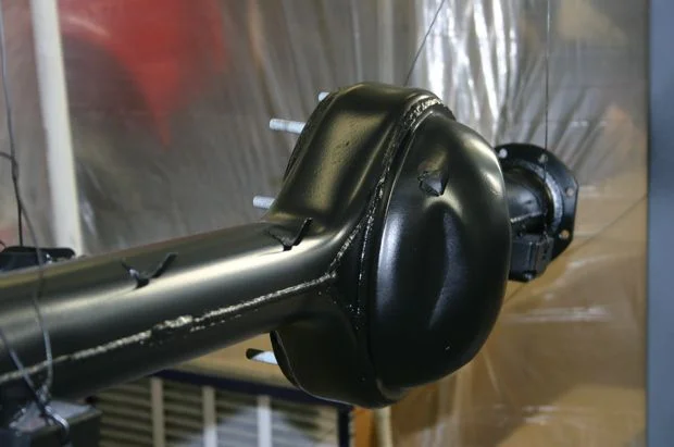

I just shot a winch for a friend with the rust bullet blackshell stuff. Straight out of a $20 gun, no thinning, minor prep. A quart of the stuff will be more than enough to do both axles two or three times, and still have a ton left over. Easy to shoot, which is good, since I suck at it. For even better protection, use rustbullet silver automotive under it.

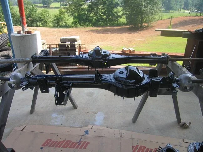

I didn't go with a topcoat because the paint jobber said I didn't need one. :0 Really, the epoxy primer is really tough stuff, and it sure looks danged close to chassis black in my book. I hate glossy frames and axles (that's for city folk ).
There's definitely some debate about using the primer as a topcoat, as it is porous (which is why it's a primer). But in New Mexico, it's dry enough I'm not in the least worried about moisture getting into the pores and doing anything untoward.
Here's some pictures of how it turned out. I'm thinking that I'll just leave it this way and see how it turns out. Our paint jobber has some stuff that lives outside that has been painted in simple DP90LF primer, and it still looks good and hasn't had any adhesion problems.
I'm certainly no expert either, but the DP primers are awesome to spray, and I'd use them even if I were to put a topcoat on (which is why I didn't hesitate to just put the DP90LF on it).

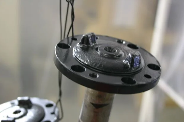

Well I bit the bullet and went with POR15. I stripped the axles with a BASG (that's big a** side grinder) with a wire cup, steam cleaned and then prepped with their metal ready. I put on two coats of POR15 about 2 hours apart (it was hot and humid so this stuff cured really fast). I then put one coat of their chassis black top coat. They look fantastic. I also painted the steering arms, axle hubs, and Marlin Tie-Rod. I decided not to do the dust shield as it's aluminum and looked pretty good after a bit of cleaning.
Here are some before and after pics:
