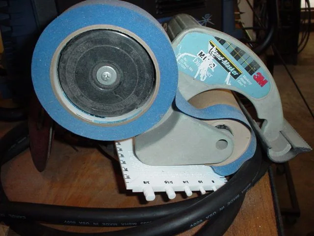

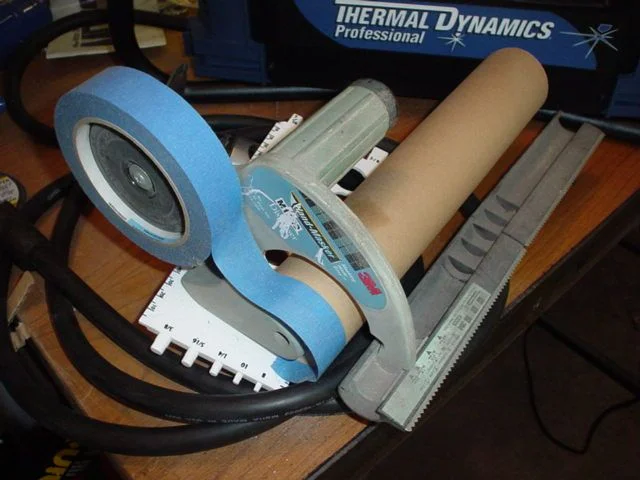

Spike, here is the one I have. Quite honestly, I've had it so long that I don't remember exactly what it cost. I just remember being kinda shocked at how expensive it wasn't. The papers come in several widths but I routinely use 12".
The model number is conveniently un-readable But I think it is "M1300"

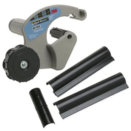

At least now I know what to look for. Searching and trying to buy right now!
Found it! $22 Ace Hardware. 3M M1000 Hand Masker
