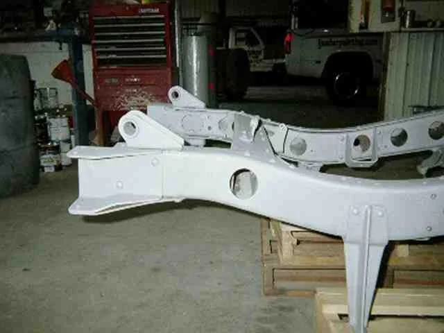

I did my frame with stratum primer, pinnacle 460 topcoat. Both Diamond Vogel products.
