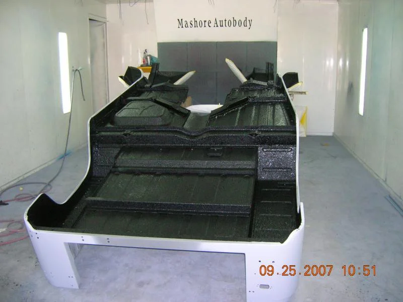

If the name really gets your panties in a twist you can get some of the other bed liners im sure. I am just speaking from exerience with this product exclusively. In fact it is the same company who makes gator gaurd, elephant hide and probably raptor liner. this is not undercoating shit its bedliner. Heres a link to the company:Manufacturer, supplier of Bedliner,truck bedliner,sprayable bedliners,pick up truck bedliners,rubberized undercoating,color your hippo,Automotive sealants,Protective coatings,Gator Guard, Anti Corrosion, gravel guard, Plastic repair, sealers,anti sto
heres the link to the liner:
products of the dominon sure seal
heres a pic of how mine came out:
good luck
heres how mine came out

we really had plans to lay it on thick , so we used 3 and a half kits ( boxes of it)
