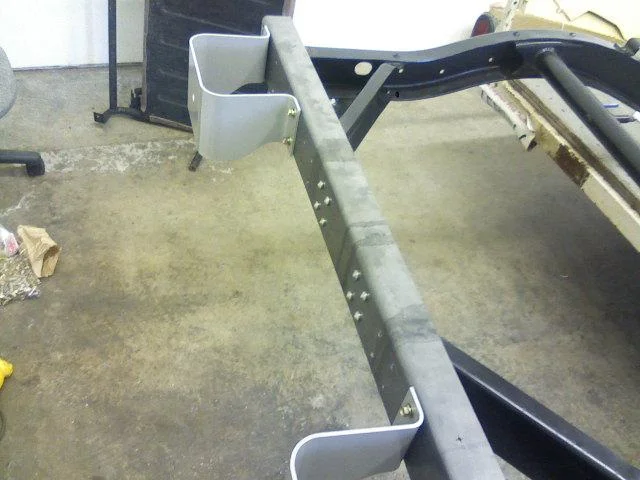

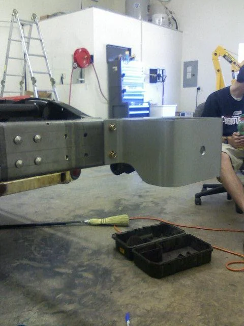

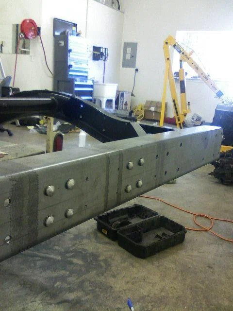

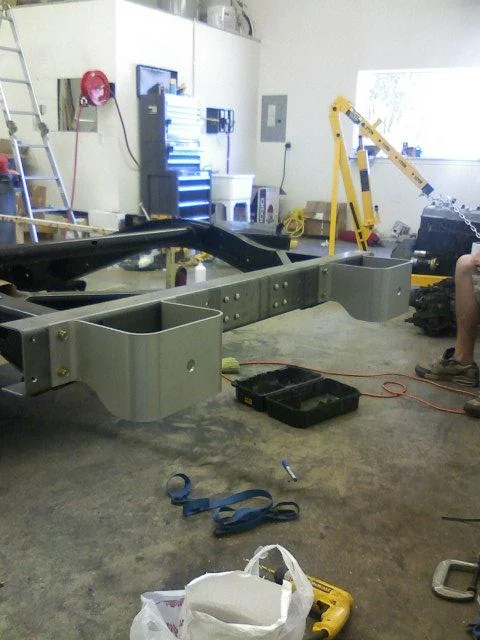

Ok it has been a little while since I have posted an update. I have had a bit of a snag. After the frame was powdercoated i realized how much damage there was everywhere. Hard to see it all when it was covered in mud rust and grime. Two of the shackle hangers were so crooked, the many rewelds had to be cut off and rewelded in the proper alignment. Many cracks were found and repaired. the bigest issue was the rear channel bumper. It was not possible for me to find one for my year. I coundnt even find one from another year. Spector had one but it was tweeked as well. The problem with my existing one was a serious warp(it was arched) from somone welding a large reciever hitch on the underside...too much heat. It had also been beat to heck. I have fabed a new channel and it turned out great!. I also machined down 10mm bolt heads to replicate the factory rivots. Here are some pictures of the first try on this afternoon. I had to throw on the bumperettes just to see how pretty it was all together.

one more

The bummer will be forking out the cash for the whole frame to go through sandblasting and powdercoating again.

Quote:
Hi Majojo4, I really like what you have done with the bolts (rivets), If you don’t mind me asking how are you going to tighten them? The reason I’m asking is that I have the same dilemma and as what you have done I would like to have mine look stock.

Quote:
Good question...here is a whole thread where I have talked to other guys about it.
http://forum.ih8mud.com/40-55-series...e-apart-2.html
