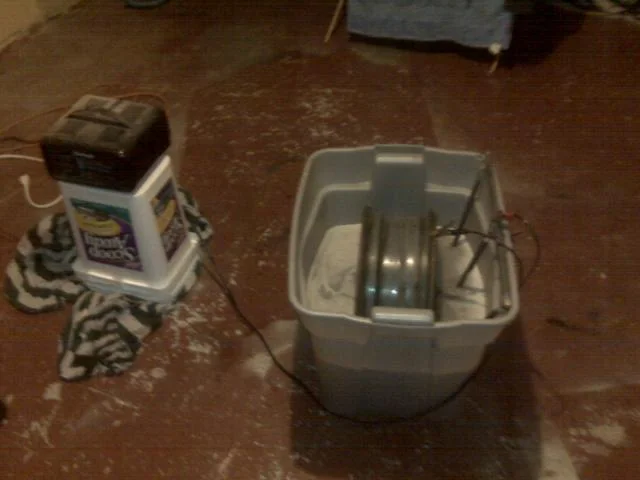

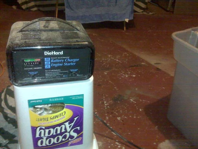

I really like this concept of rust removal. I think I read it online sometime over the summer and finally got off my ass to put it together. Right now as I type, drink beer and watch TV, I'm removing rust from ~28+ year old steel rims. I blasted the front but left the back to see what the difference will be. Tomorrow evening I will have one rim done hopfully and another in the tank while I blast off any residual rust left over from tonight.

please describe more, what are you replacing the rust with, or pulling it out with?

Its driving the oxidation reaction backwards with voltage and a basic (pH) environment.

That method works wonders, I used it to de-rust a bunch of parts before painting. It's not as effortless as it seems though, you constantly have to keep the electrodes free of crap or it loses effectiveness, and it takes a while. Also it leaves behind some disgusting crap in the bucket. But for intricate parts it's great. I used powered dishwashing detergent as the solution, and try and put the part and electrode as close as possible for quicker results.
The rust converts to a black film that just falls off with a light wipe from a paper towel. You do have to immediately paint or protect the newly de-rusted parts or it will start oxidizing immediately.

I was also using this method with some of my smaller parts, i found that a piece of sheet metal with a large surface area works best as the sacrifical lamb. I am going to ramp it up some and see if my welder set on DC will speed it up some.

Although it didnt work 100% as expected for me, it really did wonders on loosening up the rust for my sandblaster to quickly make short work of the job. I guess the small amount left over was just surface rust since it came off so easily with the media.
