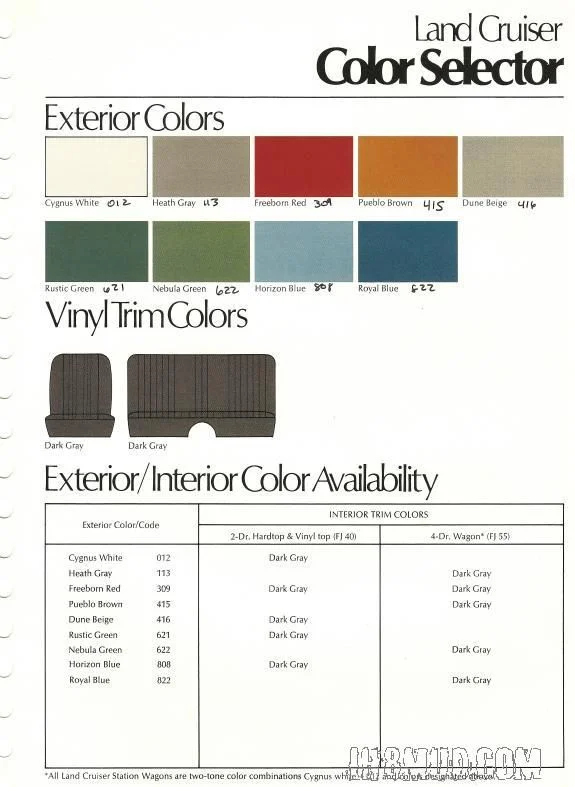

Well if this is the case then maybe my truck is not 808. Does anyone know what light blue they used in 1974? It does not look like the other "smurf blue" 40's I have seen. It is way lighter. Capri blue maybe?

Quote:
horizon blue was used in 74. straight out of the dealer book for 1974

nuclearlemon,
Thanks now I know its 808 for sure.
